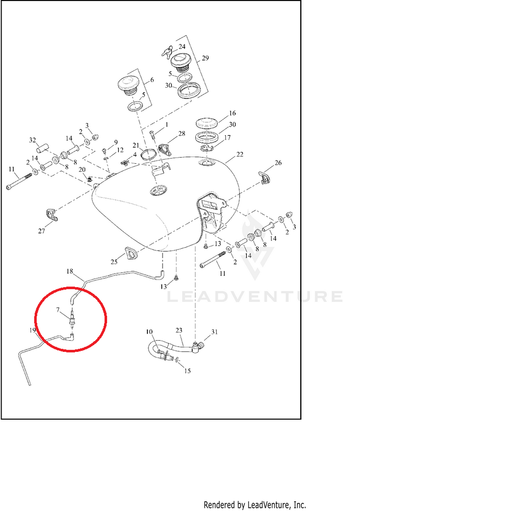

Thanks for the links to check TC's. Is that number 7 some kind of valve in the pic ? I checked the gas cap (don't ask how). When you flow air into center of the cap, it is blocked, when you pull air from the center of the cap, it flows freely. So how did the tank pull a vacuum ? It would have to be the gas cap not venting into the tank ? Just thinking. Thanks. Bob

Link to parts diagrams:
https://www.harley-davidson.com/us/e...s?aribrand=HDM
Ref:7
62150-85
VALVE,FUEL,X
Price: $19.11
I think it is a one way fuel venting valve to vent in case of excess pressure. You seem to have vacuum so I do not know.
