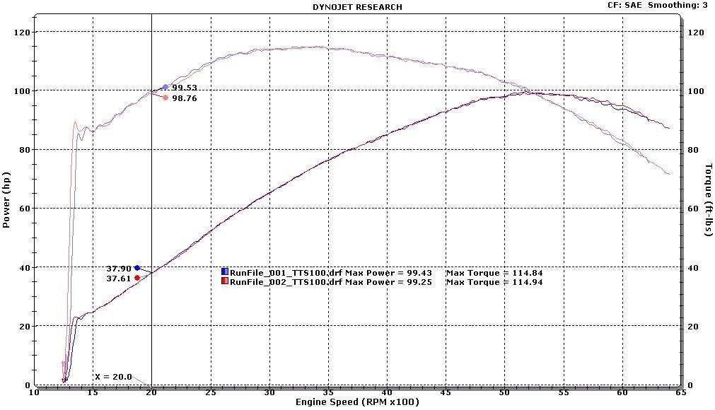

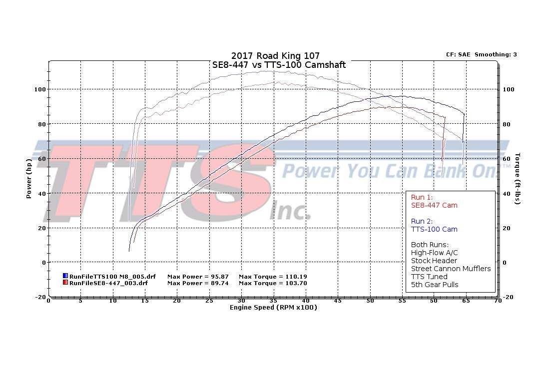

Old New Rider had one in his Heritage. I think he liked it. I have tested one in a 2017 Road Glide Special. It is a very good torque cam and probably as good as you are going to get for almost instantaneous power when you crack the throttle. The first chart is the TTS100 in my 107. The second and third charts are not my motorcycle, but will give you an idea for comparison. It is a torque cam, so the horsepower numbers won't be as high as a lot of other cams.
