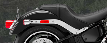

Thanks for the reply. The Low Rider has a fender support where you have mounted the box, but I think that I might be able to work around that.

Those 2 bolts up top are what you need. On mine they're right into the frame but yours has the fender rail like you said which would be in between the frame and the bracket - shouldn't matter. You just need one on the bottom. Might have to mod the bracket with a new hole as necessary. Simple stuff.

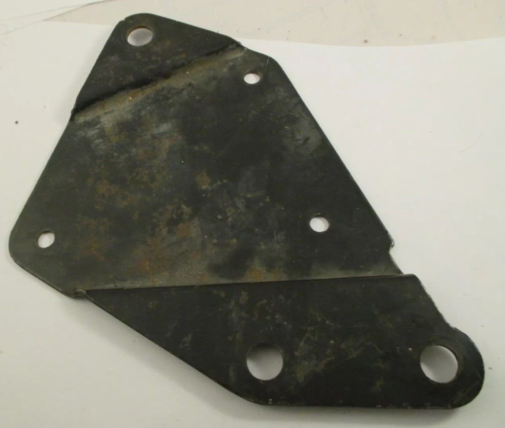

@kotkinjs1 From what I've read, different models have different brackets for the teardrop toolbox. For what model teardrop toolbox did you buy, because as you said, it shouldn't be a difficult job, as long as I have the same bracket as yours.
Old Jul 29, 2024 | 11:09 PM
kotkinjs1's Avatar
kotkinjs1
Joined: Sep 2022
Posts: 30
Likes: 19
From: Lynnwood WA
I think the one I bought was used from ebay - Harley Davidson Right Side Tool Box Mounting Bracket 64202-85a Black. Some of the ones I've seen for sale new in a kit on amazon or dennis kirk etc look pretty much the same.
