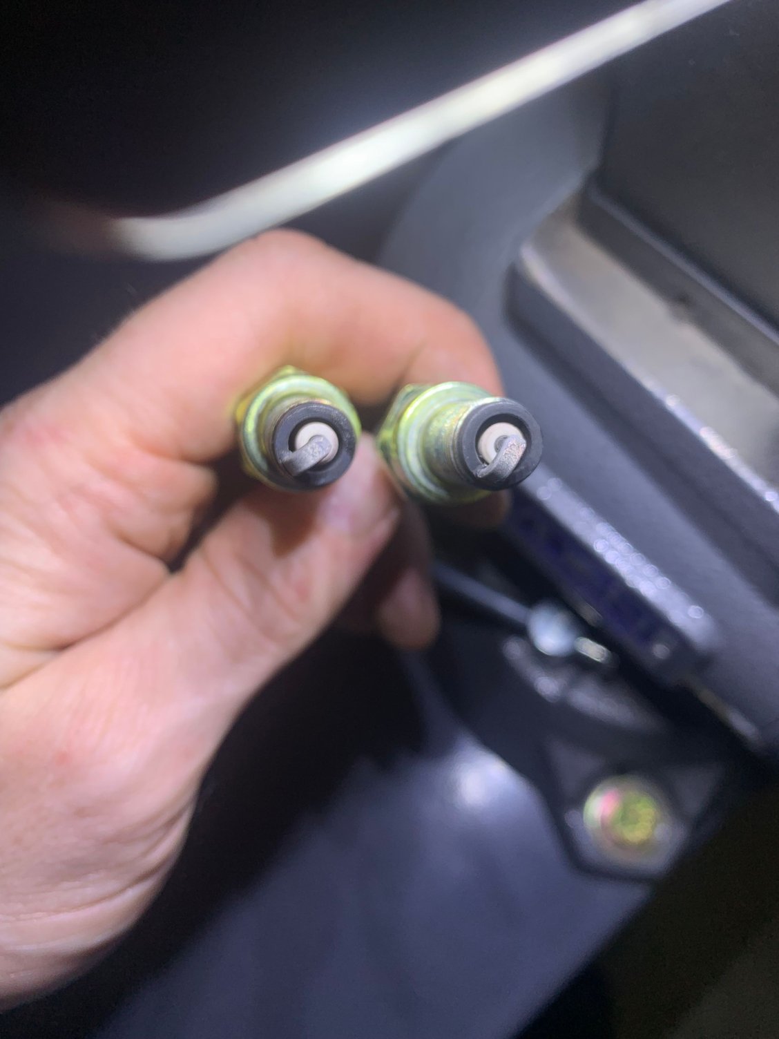

Also, here is a picture of the front and rear plugs

I'm half blind but those plugs look really lean to me . I would go with a different tune .
I thought the same thing, but the fuel smells made me think the other way around.
