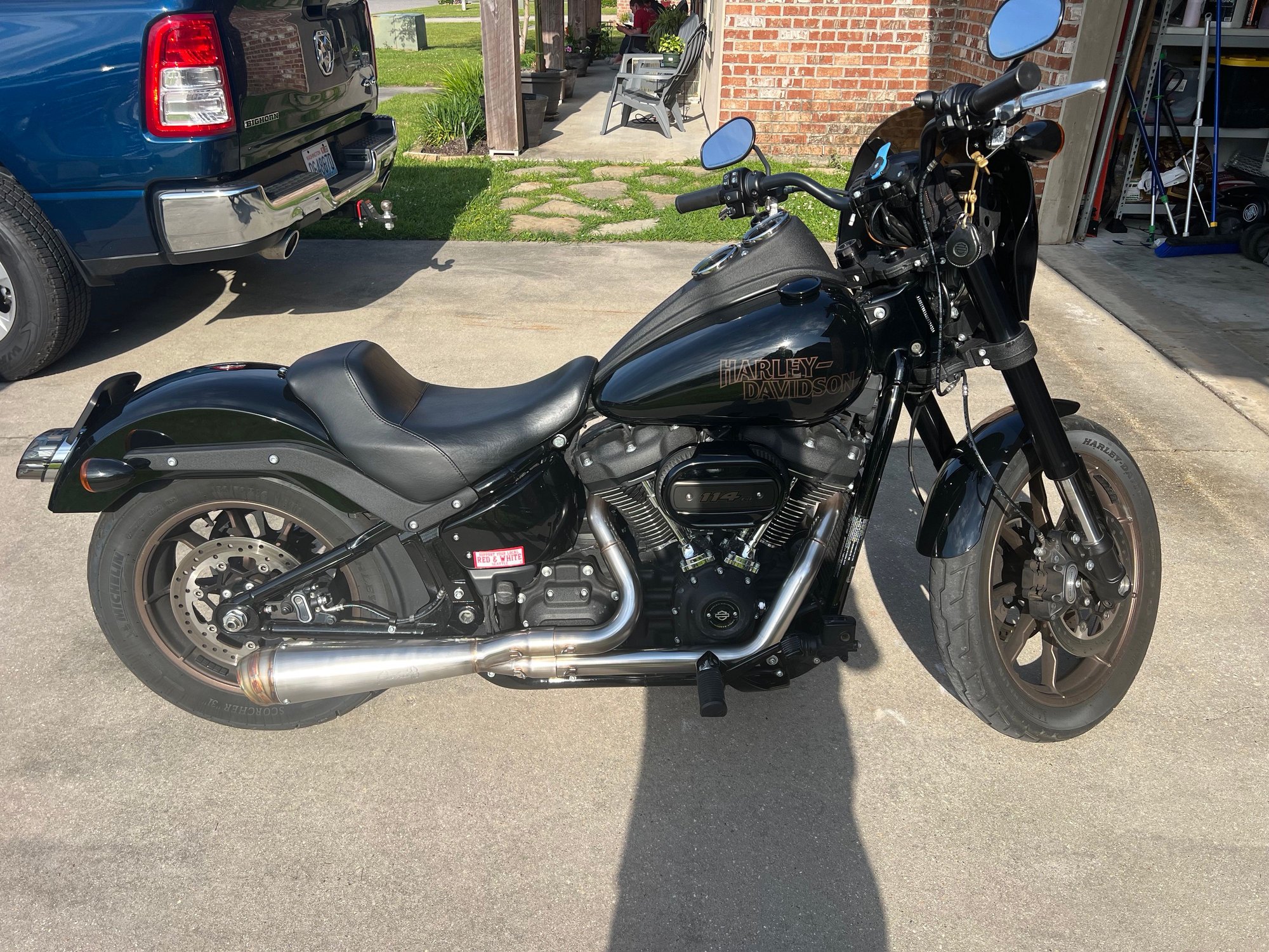

How is that? anytime you increase flow you also increase volume? Reduce the flow and its quieter. Case in point, what bike has more volume…
This one….
Or this one?

The wrap would probably seal off the perforations, making it more of a strait pipe, instead of like the cotton-y/ fluffy stuff would let the flow in and muffle it some. Like Phil said, more flow more volume. I'd personally just yank the baffle and see how it sounds without it, give you at least an idea of how loud it could be
