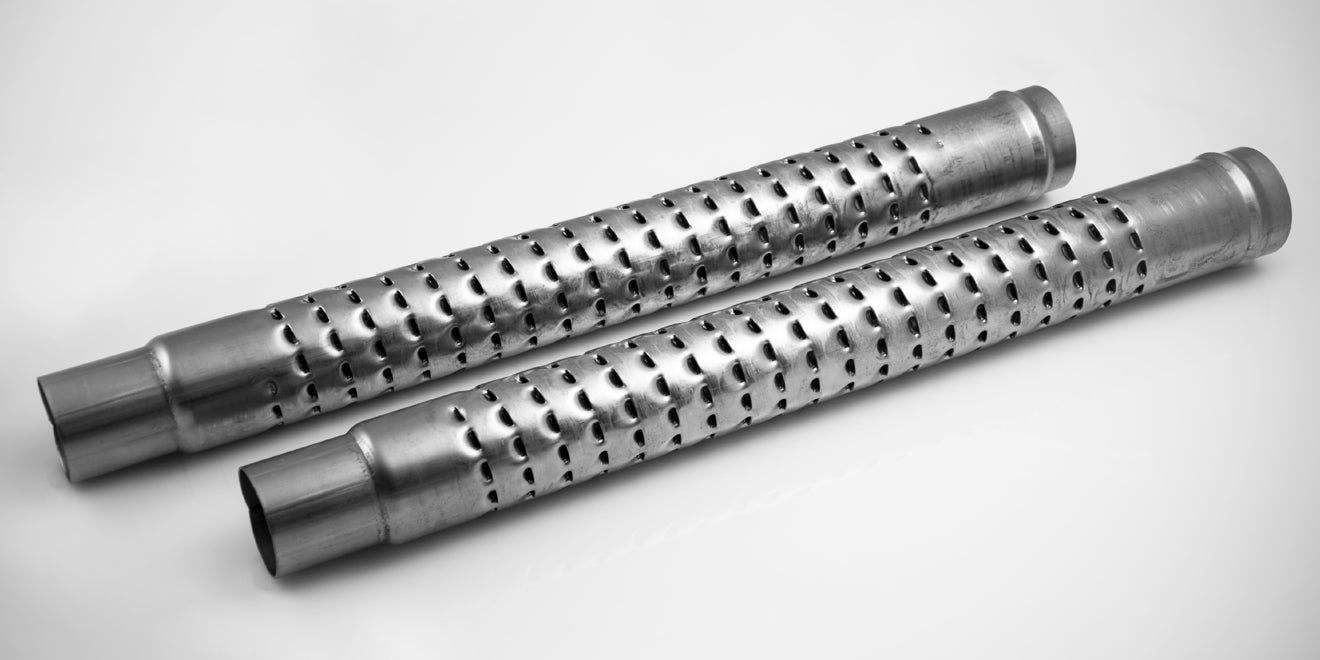

These baffles? And the exhaust flows left to right?
If so, that's classic old-fashioned "glasspack" mufflers.
They are loudest with no fiberglass packing around them.
Fiberglass tape and fiberglass muffler packing are two different things.
Fiberglass packing is loose, and rather loosely stuffed or wrapped around that pipe. The exhaust sounds go up into the loose-ish packing, bounce around, and basically fade out. That's basically how foam acoustic panels in a sound lab work.
Fiberglass tape is tight and dense. Wrapping that pipe with it would have lesser effect on absorbing and dissipating the sound. It would be roughly akin to painting the acoustic panels in a sound lab. That said, it would block a lot of the sound coming through that pipes holes from reaching the outer can, so it may well reduce peripheral noise from the pipes, particularly to the side, and may have a far greater effect than I'm forecasting.
Exhaust flow wise, neither tape nor matting should have a significant impact, because of the way inner pipes perforations are cut into it. They will still be right in the exhaust flow, and still facing the same way.
In any case, you can certainly try both approaches, glass tape and glass matting, and simply see what the results are.
Exactly!
And to go further... You attenuated energy by velocity or pressure. Fiberglass reduces velocity making it pass thru a tortuous path. Barriers are pressure based. So if sound goes Thru a baffle and bounces off a barrier and back thru... It's diminished. And all that is dependent on how thick and how long the wave is. Low frequencies have very long waves... 20ft, and you need half that to attenuate 10ft, and a barrier doubles, so 5ft.
The whole point of that is baffles attenuates sound, and fiberglass attenuates more... But you are talking an inch of space... You are only effecting waves in that length range... All you are effecting is treble, but don't touch mid/low. Sounds good, but that can leave drony, bloated sounding. And we certainly are not talking meaningful dB changes.
Full open exhausts are a different discussion. There is only so much you will get out of slip ons. Better sounding than stock for sure, but they will never sound like a full exhaust... And short shots are top end of all out obnoxious.

Thank you all that gave advice I appreciate the picture of the baffles too. They are very hard to remove , not sure I could even get them out , but they are considered removable. I like the sound, but they are just so quiet compared to my other Harleys. After all the research and talking , I think I just simply have a ,,,it is what it is... looks like a cam would be the only real fix, but I would have to pay all labor plus a tuner too, gets expensive fast. I'm happy with the power. So I would be spending a lot of $ for a stage 2 just for sound. We'll at least no one looks aggravated when I pull up to a gas pump😏. So , I got a feeling I'm doing nothing at this time. After Nov and it looks like we might get the economy back like it was 4 years ago, then I might spend the money .So far, I really appreciate all the advice .
