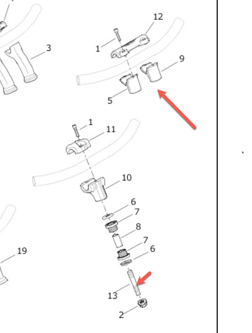

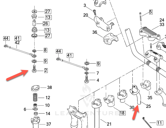

I put some Rox Risers on my bike but the full clamp on my existing stock risers cause the wires to pull tighter than I want. I see some used 4" pullback risers from a Softail Custom (FXSTC) I could maybe swap out which would take the clamp out of the equation. Any reason these risers would not work on a 2019 Heritage? It looks like the threads for the bolts are both 1/2" - 13. The risers on my bike use a stud while the FXSTC use a bolt. Seems like it should work. Am I missing something?
