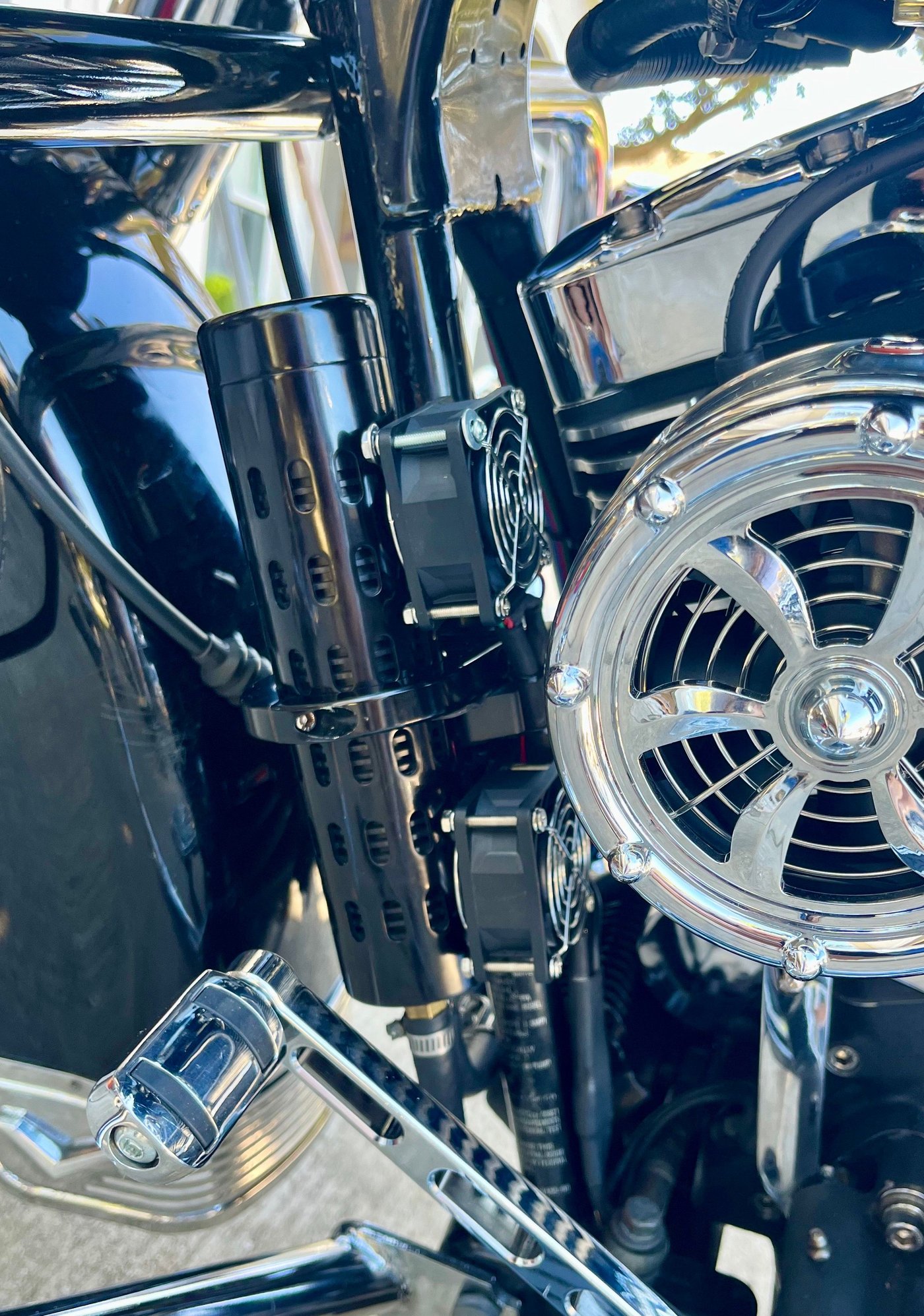

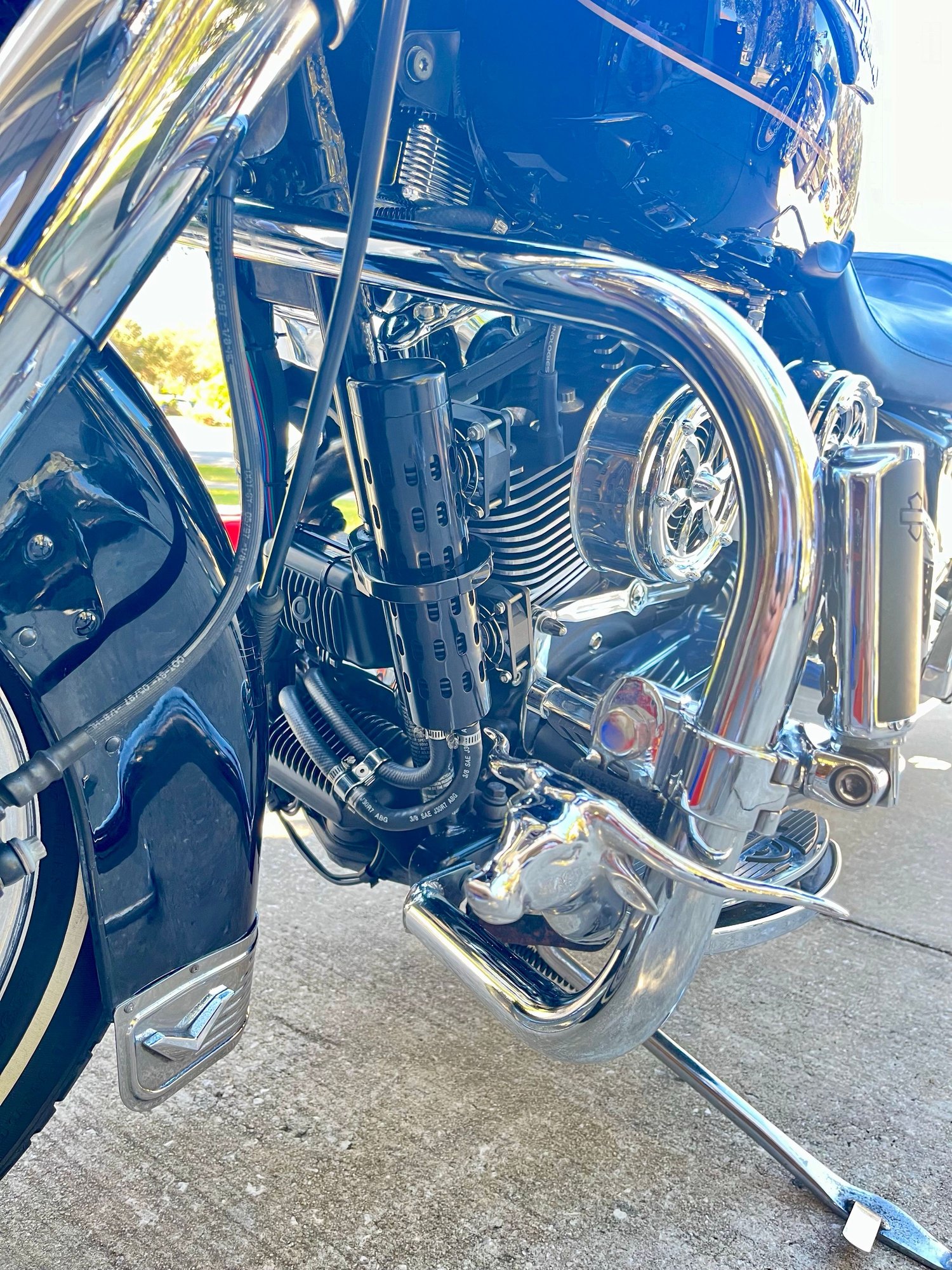

I run both oil cooler with fan and luv jugs on my bikes and I need them. In below 75 degree temps with cooler and fans off I run about 200-210 degrees, before coolers 210-225 degrees.
Above 75-80 degrees while moving I’m about 200.. but come to a light and within 20 seconds it will climb to 220-240.. with fans on it stays below 210. That’s a big difference with both running… no clue what the thermal temps are at the head.. that’s just oil temps in the oil tank readings.
Your call.
Road King 113”
Softail 127”
I have all four fans on a momentary switch with my brakes. If I use or Hold the brakes the fans run. I don’t think they are needed when moving.
