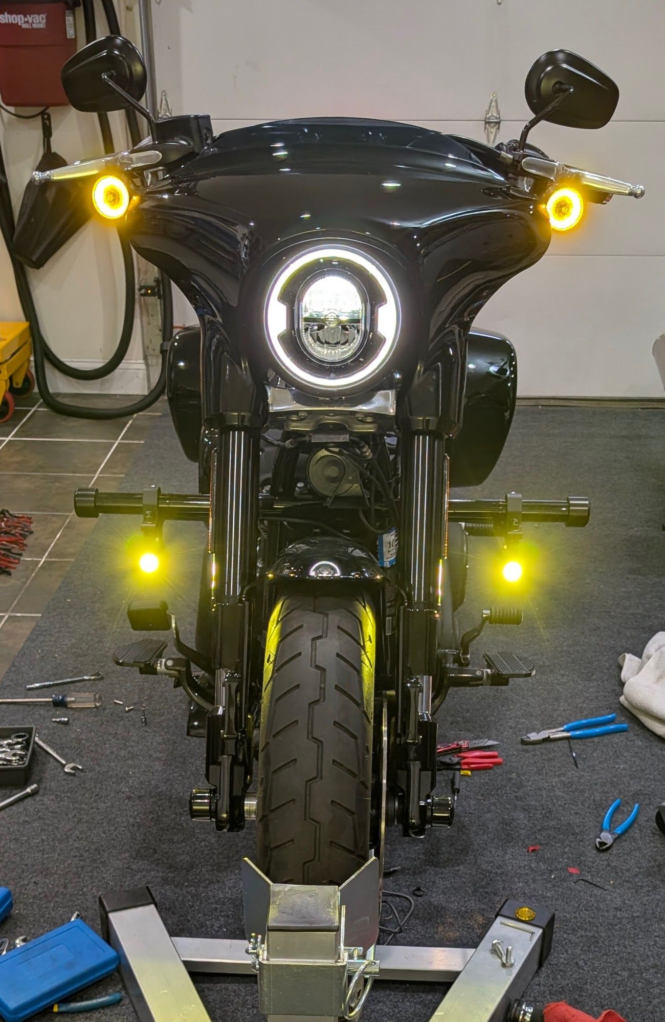

It depends. That's the best you are going to get. I'm not short. 5-11.... I had the normal low crash bars... It was a stretch. And you are not stretching out forward... It's forward and out. I really needed some extensions to get something comfortable. I was able... But limited usability.
I looked at the higher ones like mid level. Mustache bars... But I don't like the looks. Those look usable though.
I went to boards and had to get rid of the crash bar because of interference. I settled on the Harley flat out bar. I never cared for those looks either... But honestly, pics don't do justice. It seemed like they just stuck out from nowhere, but they are very noticeable. They blend in with the ST. I can prop my legs up, not sure I will, but I am pretty happy.
But... I went cheap on bars... Cause they are bars. But mine looked a tad lower than other. Just trying to look at pics of like Bung King... Mine looked like an inch lower... At most. They advertise same width as bung king. Well I had to find out... So ripped the bike over and the bar was the first thing to touch... Not good. You want foldable pegs or boards to hit first... You want warning. Sure you can hang your heel out like many do, but that kinda sketched me out leaning over. You just eat protection from drops, or sliding down the road... Lifting a tire, or hitting a high point with a board will send you sliding down the road. Now with the flat out bar.... So much happier... That's for drops or sliding down the road.
So get what you like, but to get actual highway pegs that are comfortable for tou, you might have to get extensions to get you where you want to be.

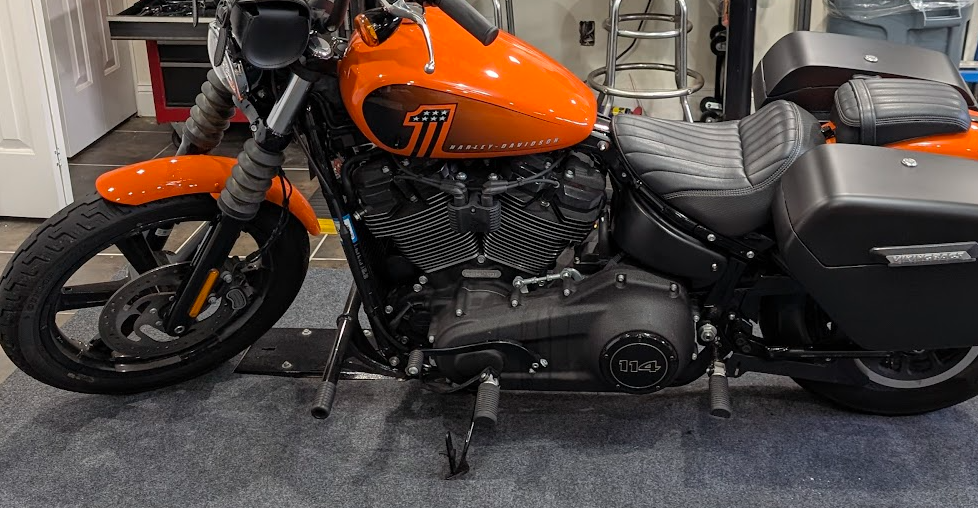

A buddy of mine installed the Hogworkz bar on his Street Bob and I would not recommend that one. It sits so low that it touches the ground before the rider pegs do and IMO is a disaster waiting to happen.
I went with the HD High bar and I think it looks fine and also can work as a highway bar.
