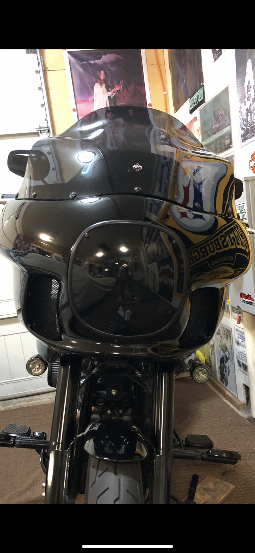

I ran one on my 2020 fxlrs. I bought mine from jd custom’s. The 3 other popular ones are Russ warimount klock werks and villain 2 hero.There is also an amozon nock off. I have since gone to the advanblack st fairing but iam thinking of putting the fxrt fairing back on. The fxrt is a little better on the highway. The jd custom required no cutting and bolted right up. I paid $1500, it comes in raw fiberglass with the brackets and headlight. $800 to have it prepped and painted.

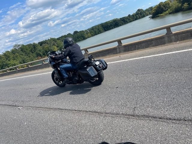

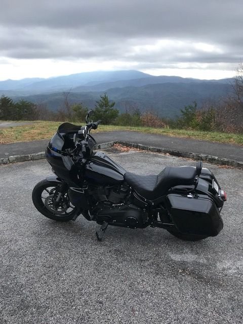

I put replica FXRT fairing, lowers, and bags on my 2020 Lowrider S in early 2021. All the parts came from JD Custom Fabrication. The fairing offers great protection, even at 85 mph. The lowers are good in the rain and not bothersome in Tennessee summer heat.

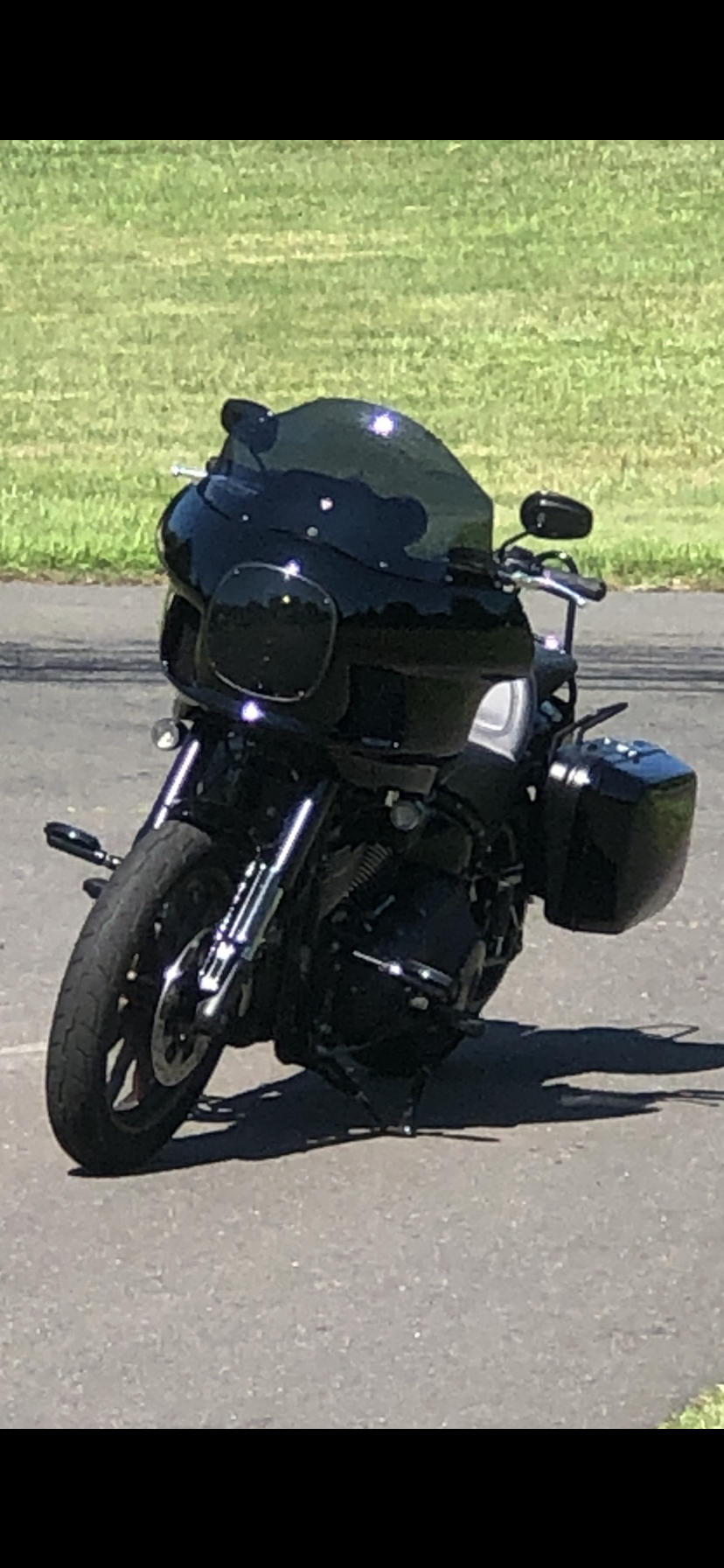

I have the Dominator fairing on my 22LRS. Had it from day one. I love it. I had a Road King and a Street Glide before. This fairing has been amazing.
