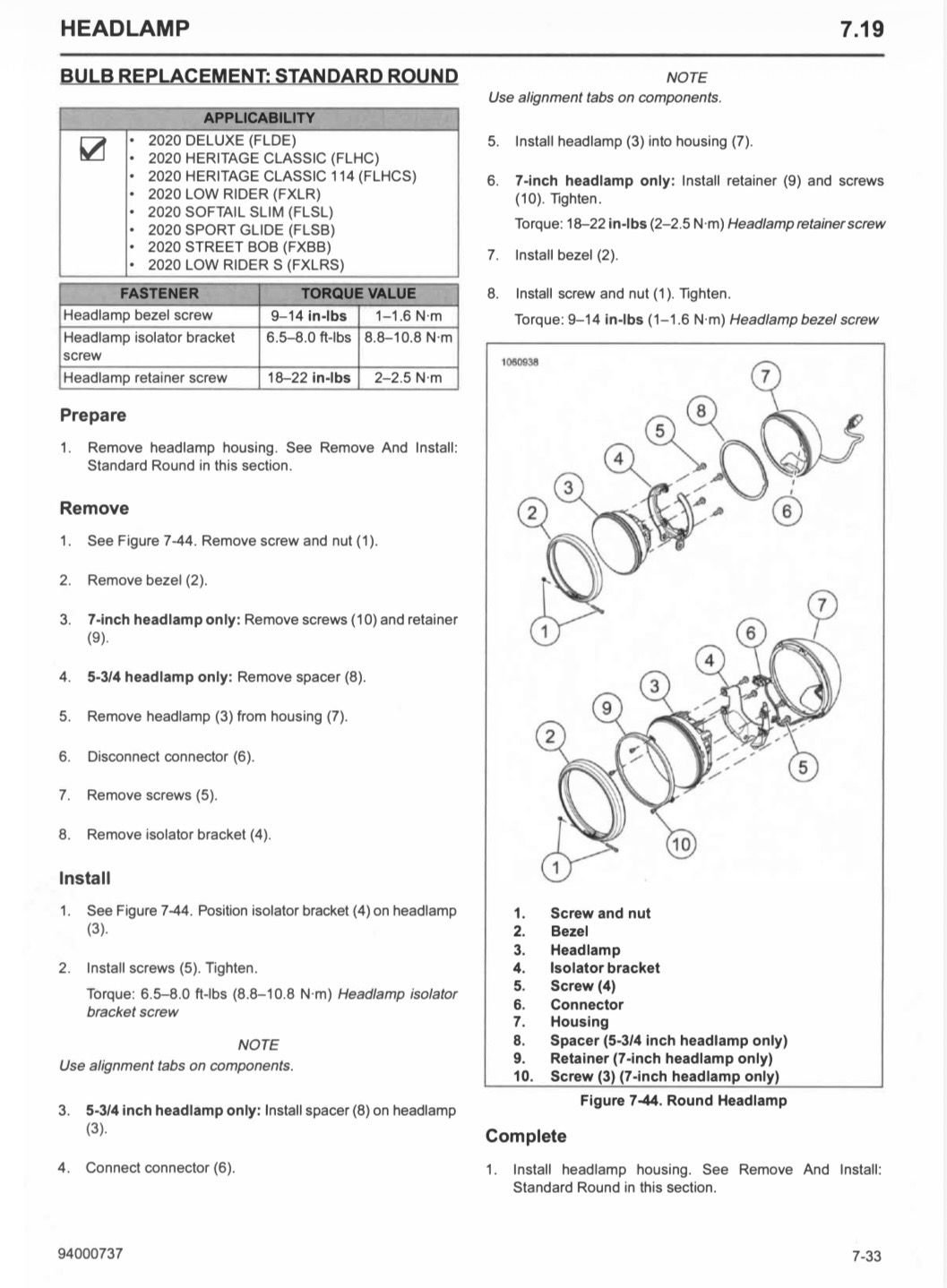

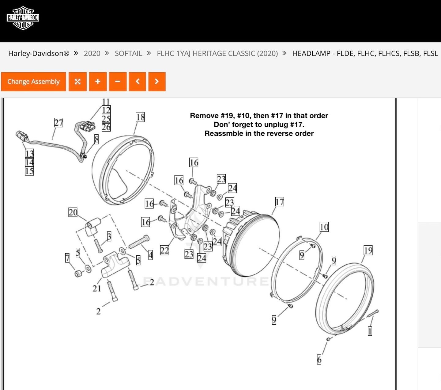

Not sure how to remove the old light? Any videos?
This should help.....

Hopefully you can remove that bottom bolt and pull whole assembly out? disconnect wiring?
