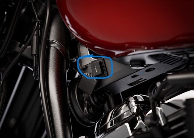

The HD website (2025 Heritage Classic) has a picture of the USB-C port located under the fuel tank on the left side of the bike. This is approximately the same location as the port on my 2020 Heritage Classic, accept that my bike has USB-C port. So, perhaps with an adapter you can use this for 'switched' power for a phone or other device.
