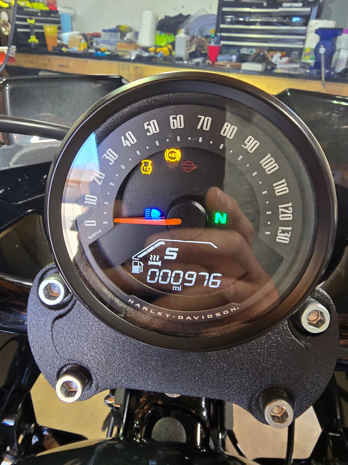

Says it has a general code, which was cleared, and then came back. Says they will update software, clear code, and flash the bike, should work... That will be $80 please....
It works. Codes gone, grips work. Level 1, 2, 3 show on the guage icon. Have a nice day... Sweet.

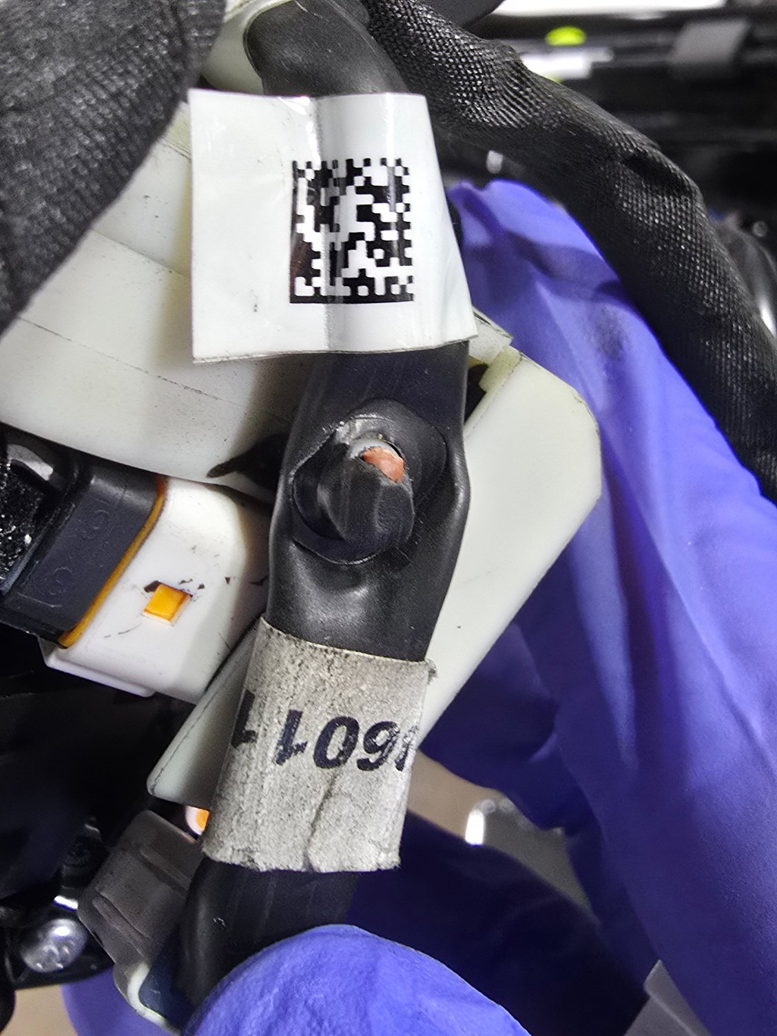

In not even going to go into details of what a complete **** show this has become... But to answer the question... Yes, HEATED GRIPS WORK.... just not for me appearantly.
So from the last post... I get my bars to swap... Go to take hand controls off... Right side heated grip wire is crushed/severed. Not sure if that's the problem, pretty sure it's not helping. 😊
So I get bars swapped, and I splice wires to get them right so I can take it to service appt today. I start the bike when done... Grips work!
So take it to service to find out my other code issues on hand controls I had before I ever bought heated grips. I head out, grips don't work, codes are back. I get to dealer... I'm like wait... I turn bike off, back on... No code, grips work. But do they actually work... Yep, they get hot. THEY WORK!
So I'll skip the part where I almost catch charges with the service ******.... They tell me it's cause my spliced wires and they can't find a problem with that... I say all you have to do is unplug grips, and it's just like it came off the floor, and you need to find out why my controls have been throwing codes since I rode it home. Final answer... They can't find anything. They saw it only happens when riding, after they rode it... But they look, they rode it again 20 miles, and there are no codes. Fine... Ride it home... Code free. Check... Grips work. Who flippin knows. If it happens again, bring it back ... I will, to a different dealership. I'll never give that one another penny.
So I'll ride it and see. I still have to take right side off and solder a proper fix and make a proper harness. When I do, I'll take pics of the offending post. I saw it, and I was sure to route around, but in the end, it shifted and I crushed it. I'm not eating $400 and getting another pair.
At least for now, 25+ Softail can run heated grips regardless what ever old instructions say. With all my code issues, I can't say for sure if I needed my bike flashed... But don't be suprised at all if you do. Follow the directions... DO NOT turn on grips. You have to run bike for 5 minutes for software to install and then see if they work. Appearantly that's a thing. But I did do that and first guys said I did need a couple updates. And they did work then... Before I rode it home.

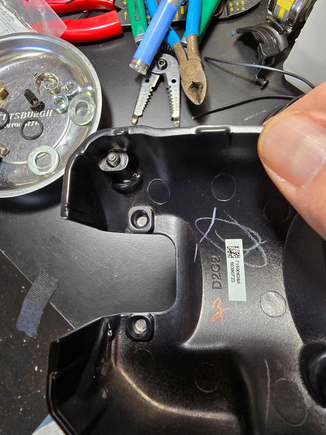

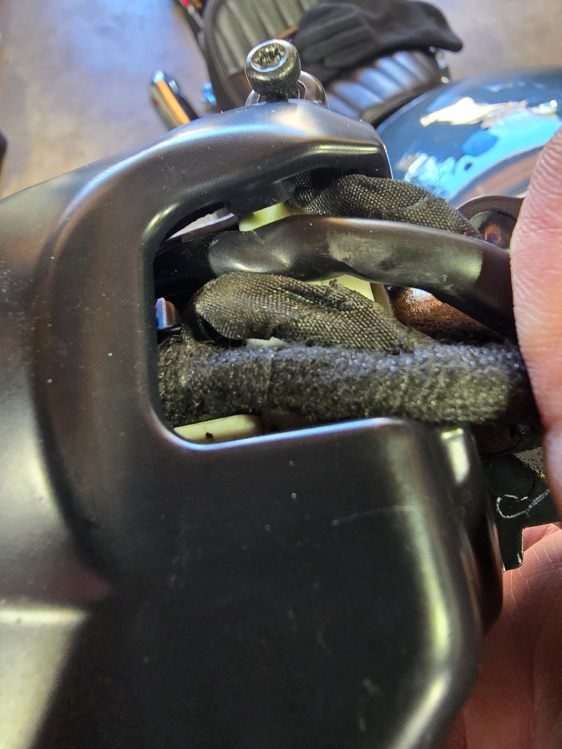

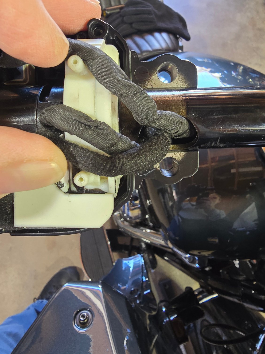

Enough of all the drama. I got my new harness built best I could. Soldered new wire in. Close to original. Now that I get it all it's pretty easy to make sure all wires are routed correct and safe. Here's a couple pics...
Bottom line is the new grips, besides just the simple pig tail to plug is, the grips them selves are much easier to change. They lock into control, just slide right on. No throttle tube to mess with, stick down left side... Slide on lone, locked in place.
So if you are worried about Softails, don't be. Any new styles with pig tail and new controls will work. At worst, you will need a flash, and for now, I think that's likely. But ya, right now, product compatability info is just not updated.
