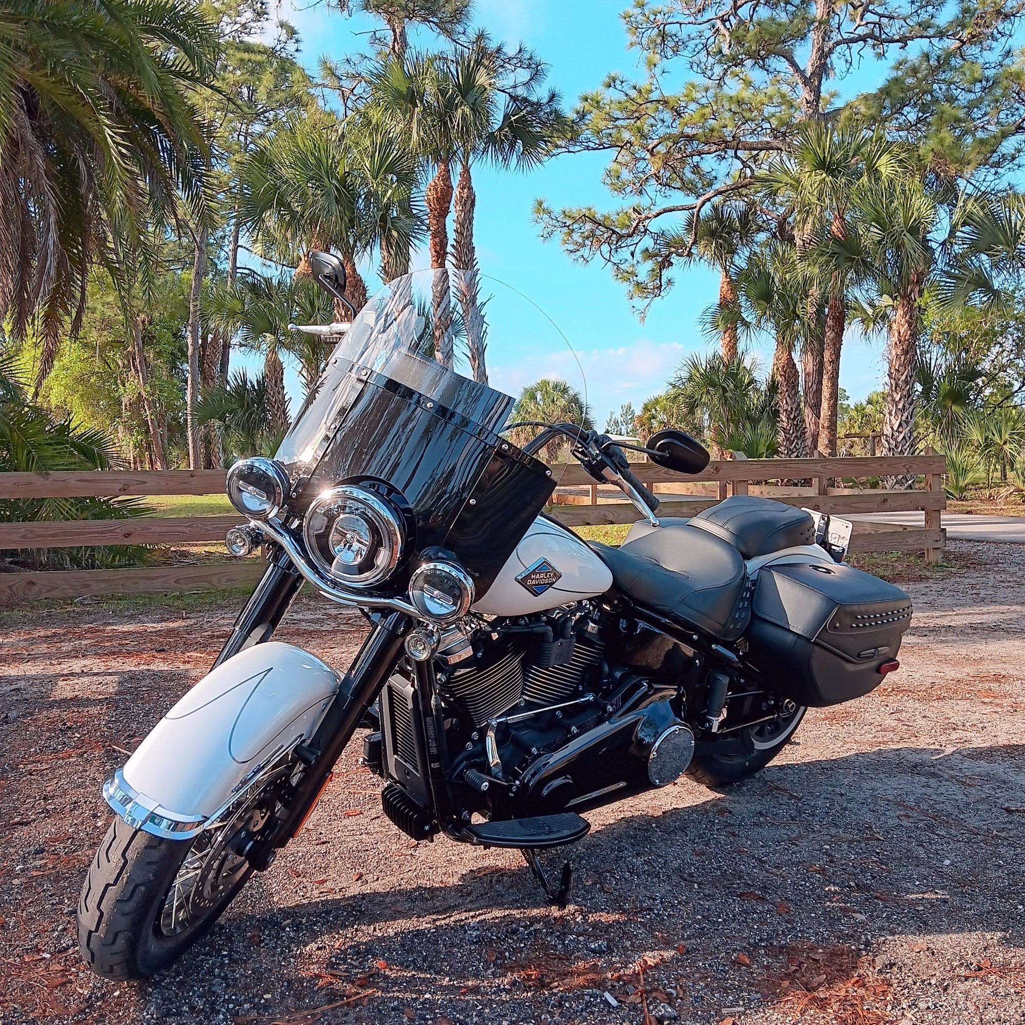

New bike day. I traded in the Fatboy for a leftover 2025 Heritage, arrived yesterday. I'm a little concerned, I have a bit of oil coming out the back of the air cleaner, I put 102 miles on it so far. I'm hoping it's breaking in, and some blowby that will seal, but time will tell.
Looking good, I think. I had 45,500 miles on the 2021 FB, it was a great bike.
