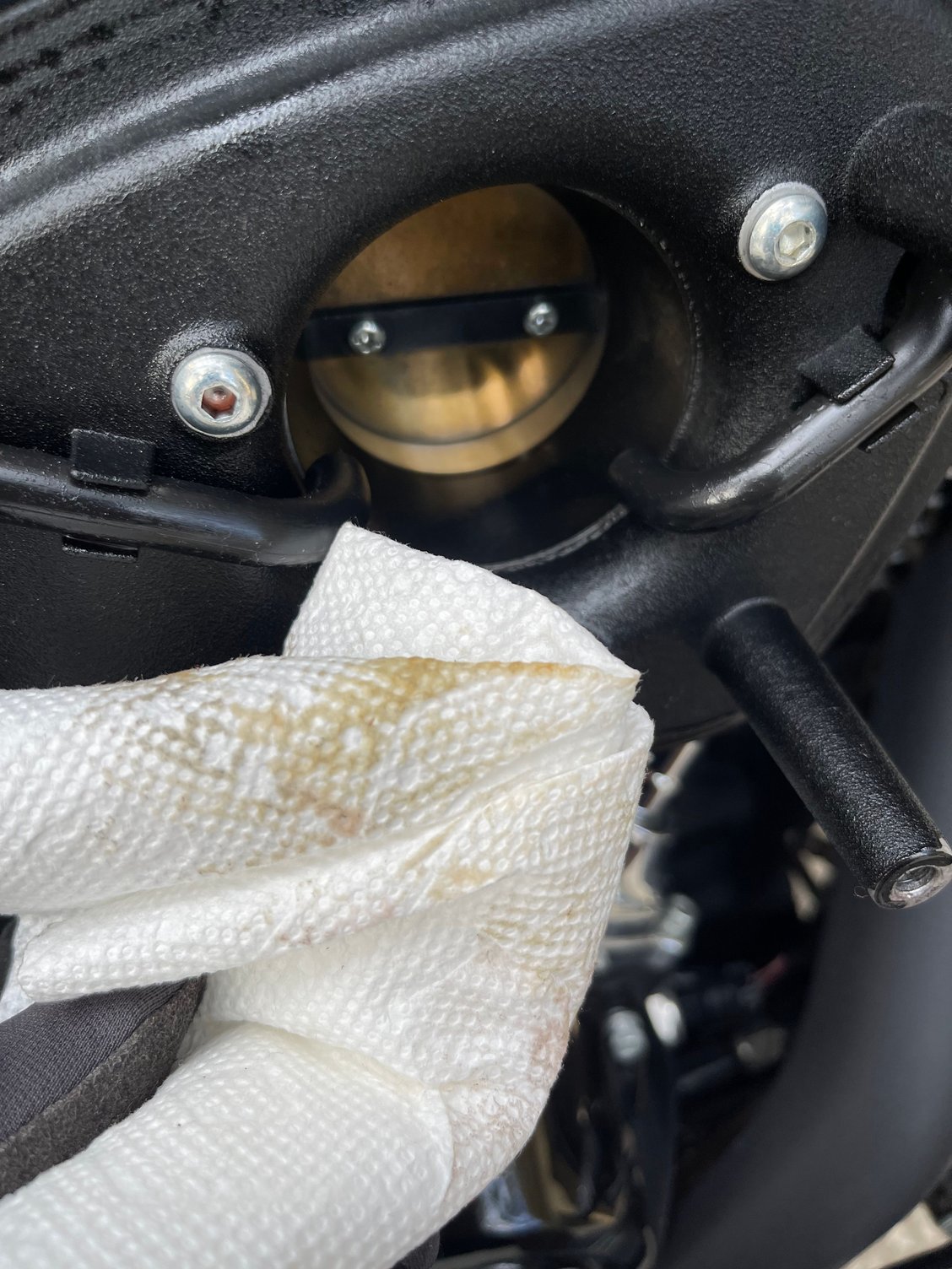

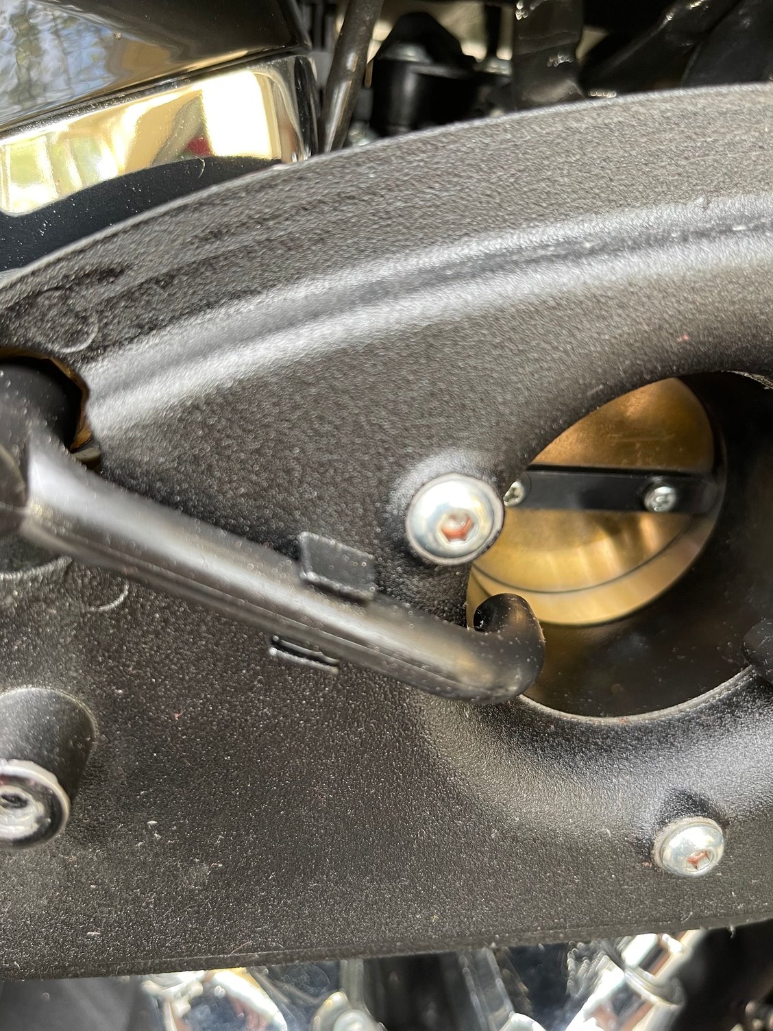

2018 RGS. Bought it recently with 5600 miles on it. Took it on a about a 400 mile trip yesterday and found a lot of oil being blown down the side. My kid has the same bike with a lot more miles and a few mods. He doesn’t have this problem at all. He has a different air cleaner (Arlen Ness). Currently I have the SE (previous owner installed it or had it installed).
My only other M8 experience is a 2020 RKS that didn’t do this either. It had the stock air cleaner.

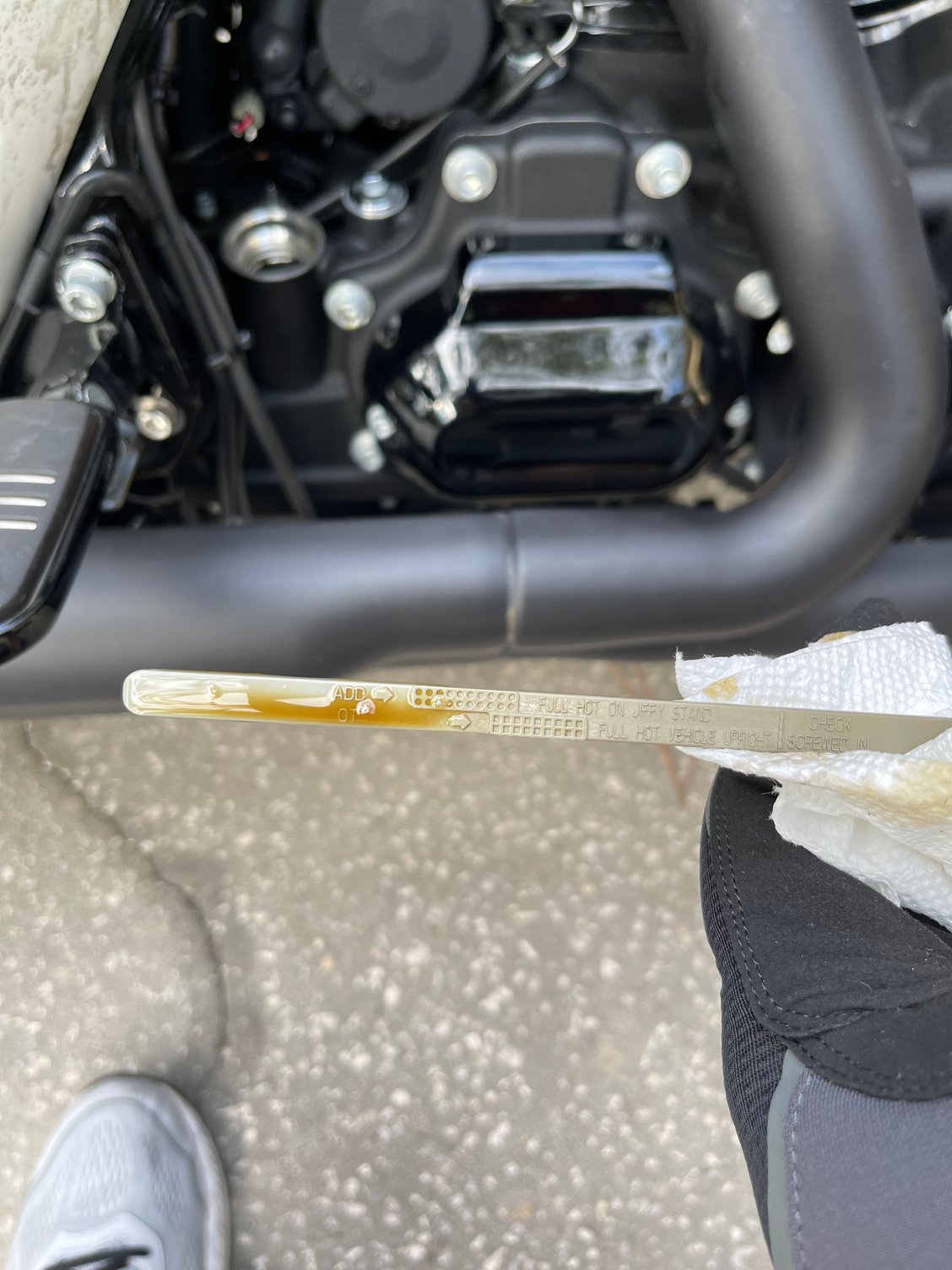

Checked the oil. It’s about half way on the checkered section, so I don’t think it’s over-filled.
I know a little oil is normal. This seems excessive.
See pics.
Thoughts?

When I checked the oil, I started it and let it idle for about 5-7 minutes or so, then let it sit for about a minute. The pic shows the oil level as tested on the jiffy stand.

I believe they have updated breather hoses for that air cleaner that raises them higher in the intake which helps to prevent oil from dripping out
yup, and they go further in as well..we went thru this on both our early SE Hi Flow ACs and when we upgraded to the new tubes it dramatically reduced this problem, which they obviously discovered and made an improvement to resolve

Well it may very well have been over-filled previously and it just blew out all that it needed to while you were riding and then once the motor found it's sweet spot, it stopped spewing. Clean it all off and ride it around some more and see if you're good to go.
yup, and let the oil level drop to add level if it 'wants to' and maybe even settle there and most likely won't have oil on the side of your bike anymore..even running around 1 qy low at the add mark provides sufficient safe level for the engine to use..of course you would then need to keep a close eye on it from there on out
