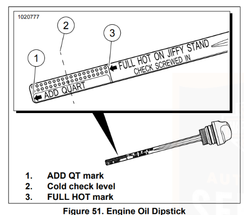

Originally Posted by Jackie Paper
@Ralpf Muchachio. Is your stick similar to most Harley nowadays with dual markings for stand and upright.
Obviously, the way these bikes are modified, if lowered one would use the upright.
I wonder if that's not an upgrade for 24+ M8's. Mine is a 23 Fat Bob 114 and the dipstick matches what's shown below from the manual: A well defined hot full mark and an instructions-sourced halfway point full cold mark.

Your 23 did not come with the new dual position dipstick, it's a jiffy stand only dipstick. You can apparently change it to the new one, if you wish, but I see no advantage in that.
I've had similar mysteries with my 23 and its wandering oil level. Similar my old TC88 for that matter. It's to the point that I just ignore the "check hot" proceedures, and just use the cold, not running, quick check before I ride. That is the most consistent. Though depending on the angle of the ground upon which the jiffystand is resting, that can be off. Not an issue when at home, but it can be while out traveling.

Well, I believe this mystery is solved.
going by the “initial fill quantity“ of 4.0 quarts, I added just under 4 quarts, watched the dipstick for the ‘’full cold” mark and then took a ride. I should have verified everything with a hot check done according to the manual.
yesterday, I added about a third of a quart and took another ride, after which the hot check showed that the oil was just into the fill area a millimeter or two above the “Add Quart” line. I went ahead and added another quarter of a quart and the dipstick went up again.
To summarize, 4 quarts left Me in the “add a quart“ area, which was not enough to trigger any oil lights or other behavior. I have a little over 4 1/2 quarts in it now and it looks to me like I could probably put another half of a quart in. I had let the oil drain for quite some time when I was changing it, but the 4 quarts suggestion does seem like a “starter“ as someone noted earlier. an earlier poster had suggested that 4.5 quarts might be the sweet spot, and I’m inclined to now agree. Overall, I think that the dipstick is fairly reliable if the manual instructions are a bit confusing

The owners manual states that the bike should be on the Jiffy stand for cold or hot checks.
