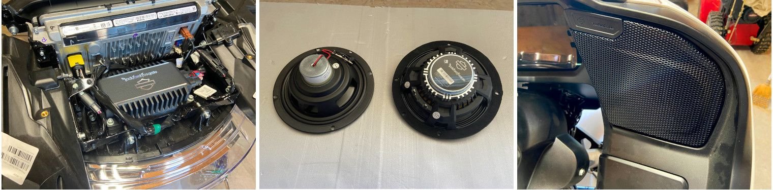

OK.. reporting back.. Spent a few hours in the garage this afternoon installing the RF 500W amp & RF Stage 1 speakers in the fairing. (Will tackle the tour pack speakers at a later date).
The amp went in OK. Pretty straight forward. OUt of interest, I got out the kitchen scale. The stage 1 speakers weigh 23.7 oz vs 13.0 oz for the stock speakers.. I wouldn't call the stage 1's beefy, but the magnets are noticeably larger.
The sound is way better than I thought it would be. Head and shoulders over the stock setup. I haven't been on the road yet, but I found it unpleasant to listen to at full volume in the garage. I can feel the bass notes with my feet as they vibrate the floorboards. I'm amazed to see so much bass out of a 6.25 inch speaker. And these are Stage I, (4 Ohms at 75W). I can't imagine the stage II and III (2 Ohm speakers at 125W)... Or for that matter some quality 2 Ohm speakers from outfits like Hertz or Polk.
Even with Stage 1 speakers, I'm counting this upgrade as definitely 'worth it'.
