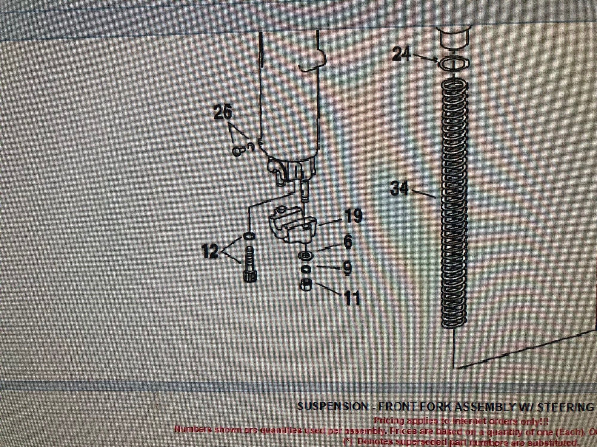

Originally Posted by Ward1963
Do u mean torx head cap screws? I have a new set that should cover everything. Also bought a allen head set screw to ratchet set that has the lil to the thumb size. Good idea on the wheel bearings.duhh. Thanks for the info.

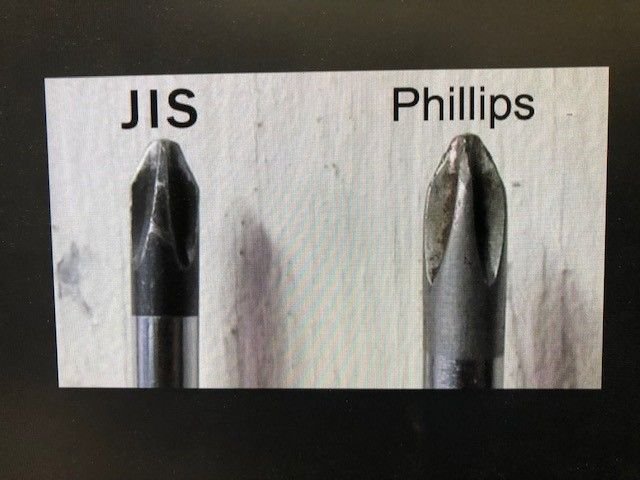

Item 26 shown below is the drain screw. Grinding the tip of a standard Phillips provides a better fit in JIS screw ( see pic )
Item 12 sometimes requires the quick action of an impact to prevent the damper rod from spinning
REMINDER , these forks were made in Japan item 12 is METRIC
You round out ( strip) either of these fastener heads and you`ll regret it.
