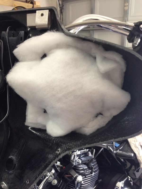

Here's some pic's from other members bikes, look's like zip ties on most?

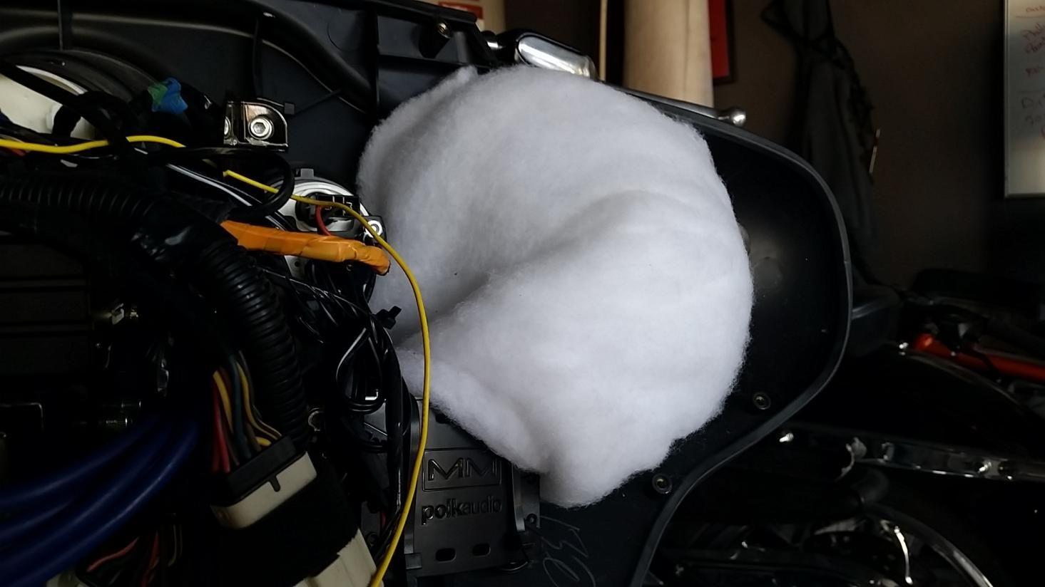

second pic is my bike with old SS amp in it - TOO MUCH poly there... only need 3 layers, that was as I can recall 5 layers.
no need to zip tie, it will stay put...

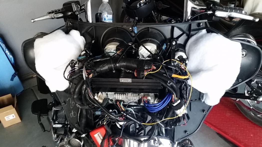

correction, 3rd is mine too lol...
that one has 3 layers. you can see the difference and "how to tuck in"
