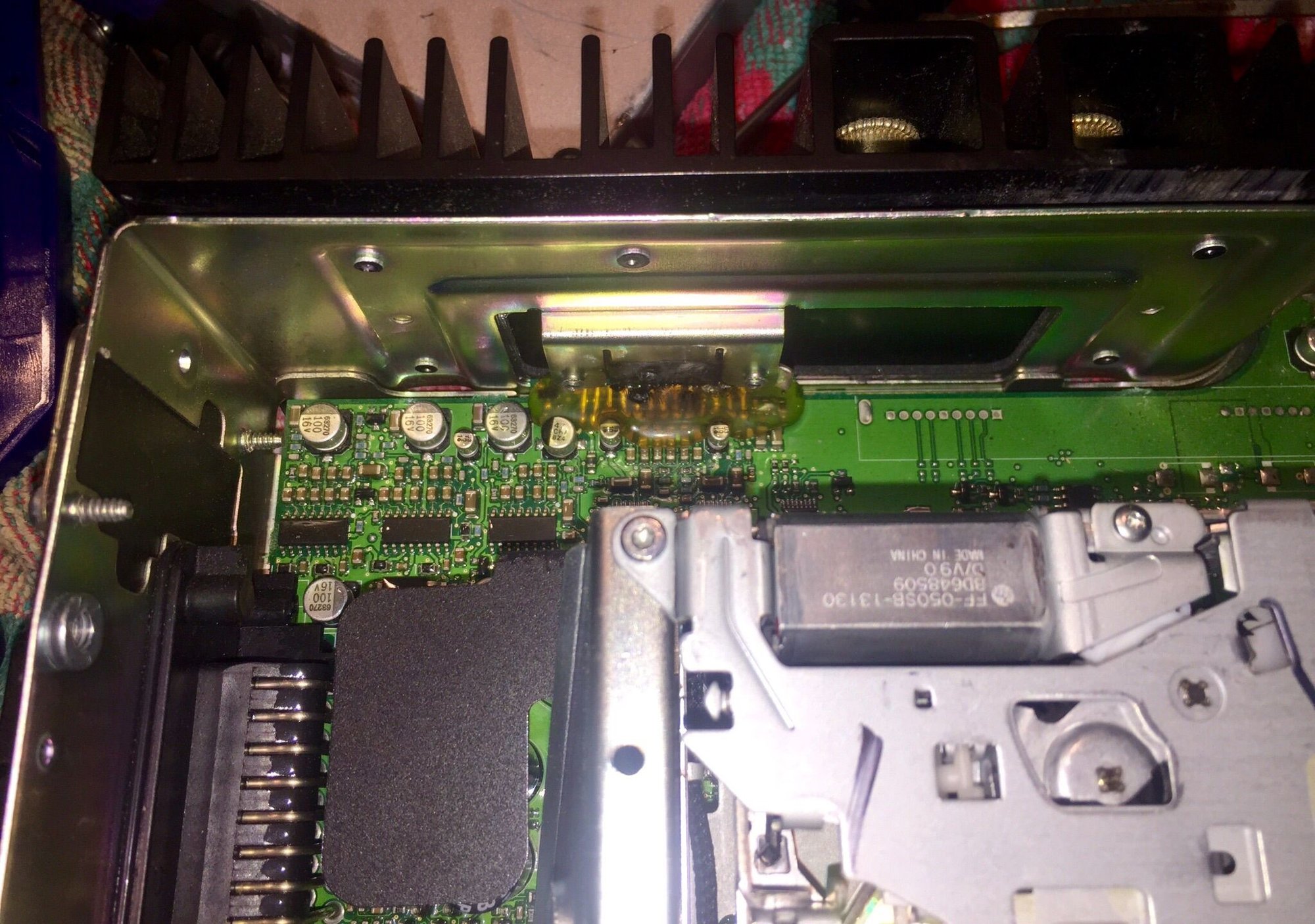

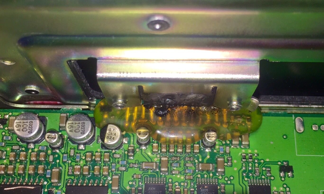

I've been putting my 09 Ultra back together after getting all the tins painted and installing new 12" Yaffee Bagger Bars. Get everything connected and no sound out of the head unit. Then all of a sudden I see and smell smoke. Cut power and disconnect the battery. Could see smoke coming out of the HK Head unit. I pulled it and opened the top. Here is a couple pictures of the area that was smoking. I am running a Cerwin Vega B4 amp for the front upper and lower speakers and a Cerwin Vega B2 amp for the saddlebag speakers. I assume the head unit is likely dead? Since my wife and I use the intercom when we ride together, I have to stay with the HK. All the switches on the handlebars functioned as they should.

I suggest sending it to Iron Cross Radio, to get an estimate to repair. Or just put an add on this site forva take out radio.
But,IMHO it looks like you fried the output SE tion of the amp. Verify you wiring is not shorted, your external Amps are connected properly, and the amps match the impedance and output capacity of the head unit.

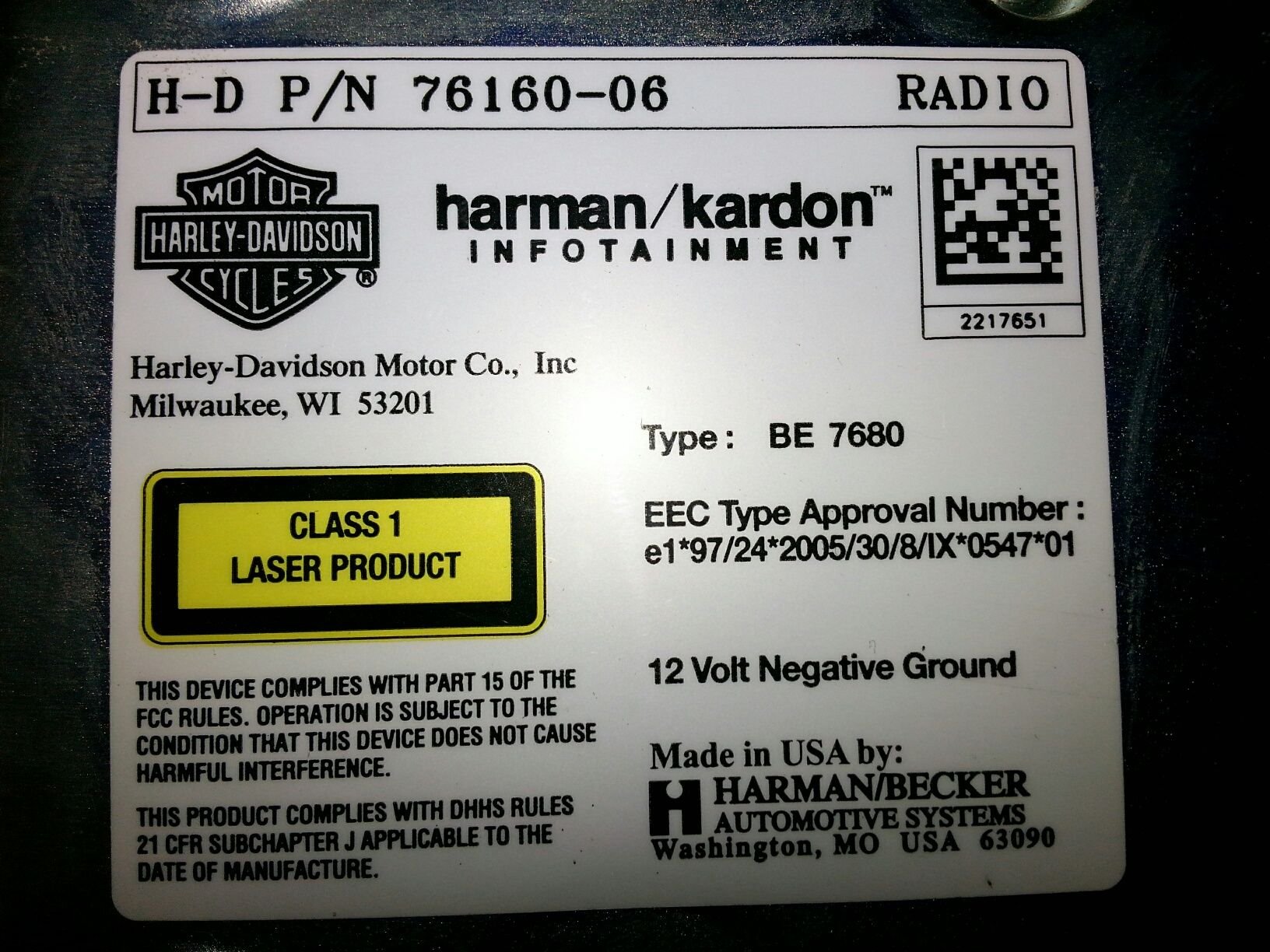

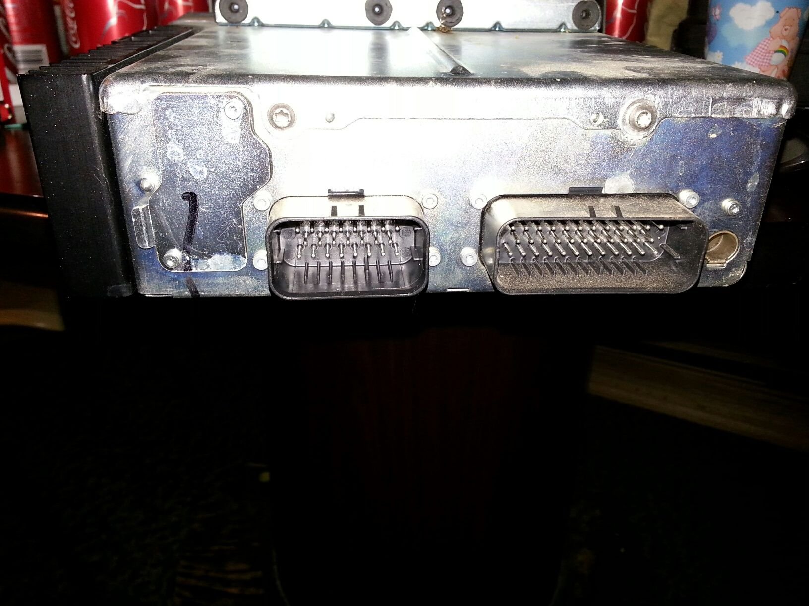

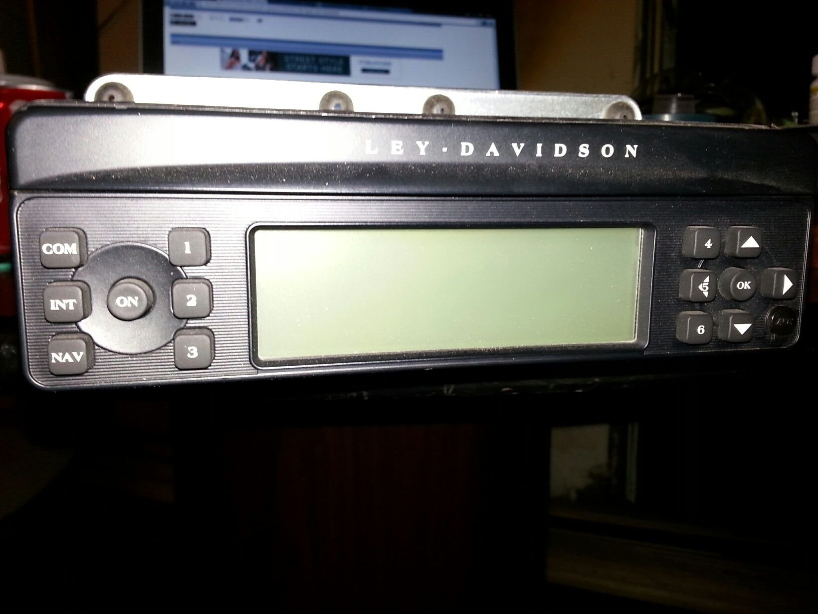

Here's the front, back, and picture of the units tag.
