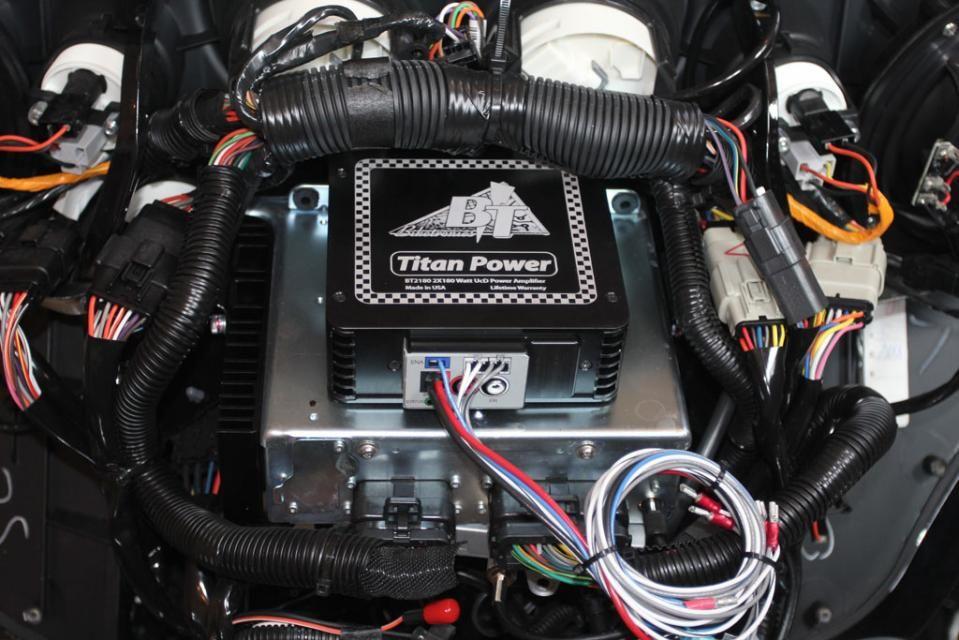

As much as I tried can't seem to get the BT2180 to fit under the batwing fairing. It hits on the outer fairing when I try to close. Any suggestions or tips?

What radio? Do you have a CB or xm modules installed? if so they need to be relocated.

I have the HK Stock HU. The CB and XM modules were re-located. The BT amp appears to be hitting the top rib on the HK HU. Do you have to cut that rib off? I also notice the BT2180 is wider (5.25" vs 4.25") and taller (1.8" vs 1.5") than the PBR 300x2 it is replacing.

Here's a pic from another member. Does your setup have the same clearance.

No. I don't think I had that much clearance. I oriented mine 90 degrees from that shown as it was the shorter dimension with the connections on the end of the amp. I had about 1/2" to 9/16" to the back edge of the HU. The top corner of the amp is what is hitting the outer fairing. I estimate I need about another 3/4" for it to work.

This photo is mine, I just installed last week. It sits flush with the edge of the HK HU, I also have the rib down the center, I used a velcro and a rubber gasket sandwich to raise it up about 3/16" so it wouldn't teeter/totter on it. No problem clearing the inside of fairing.
