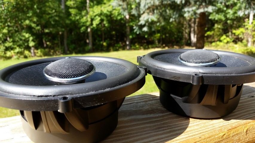

Here is what happened to my Kappas mounted on the outside. I had them inside last year but they sounded hollow so I put them outside like stock...huge sound improvement, but they got damaged.

Yikes, that's tough to look at. I'm trying to nail down a setup where I only have to remove the fairing once.
