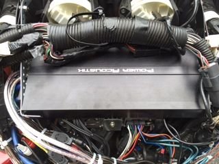

Okay Bro your audio is about to change big time!! The first thing you need to do when you get the amp is take the handles off of it. Two screws and the handles pop right off. Gonna take a little elbow grease to pop them off. Head to Home Depot and purchase some INDUSTRIAL VELCRO. Mount the amp on top of the radio with the industrial velcro. Push the amp all the way back to the gauges. After you tack it down it's not going anywhere. I couldn't find a pic of the RZ4.2000D but I do have a pic of the much bigger RZ4.3000D. Same concept only I used brackets on the bigger amp.

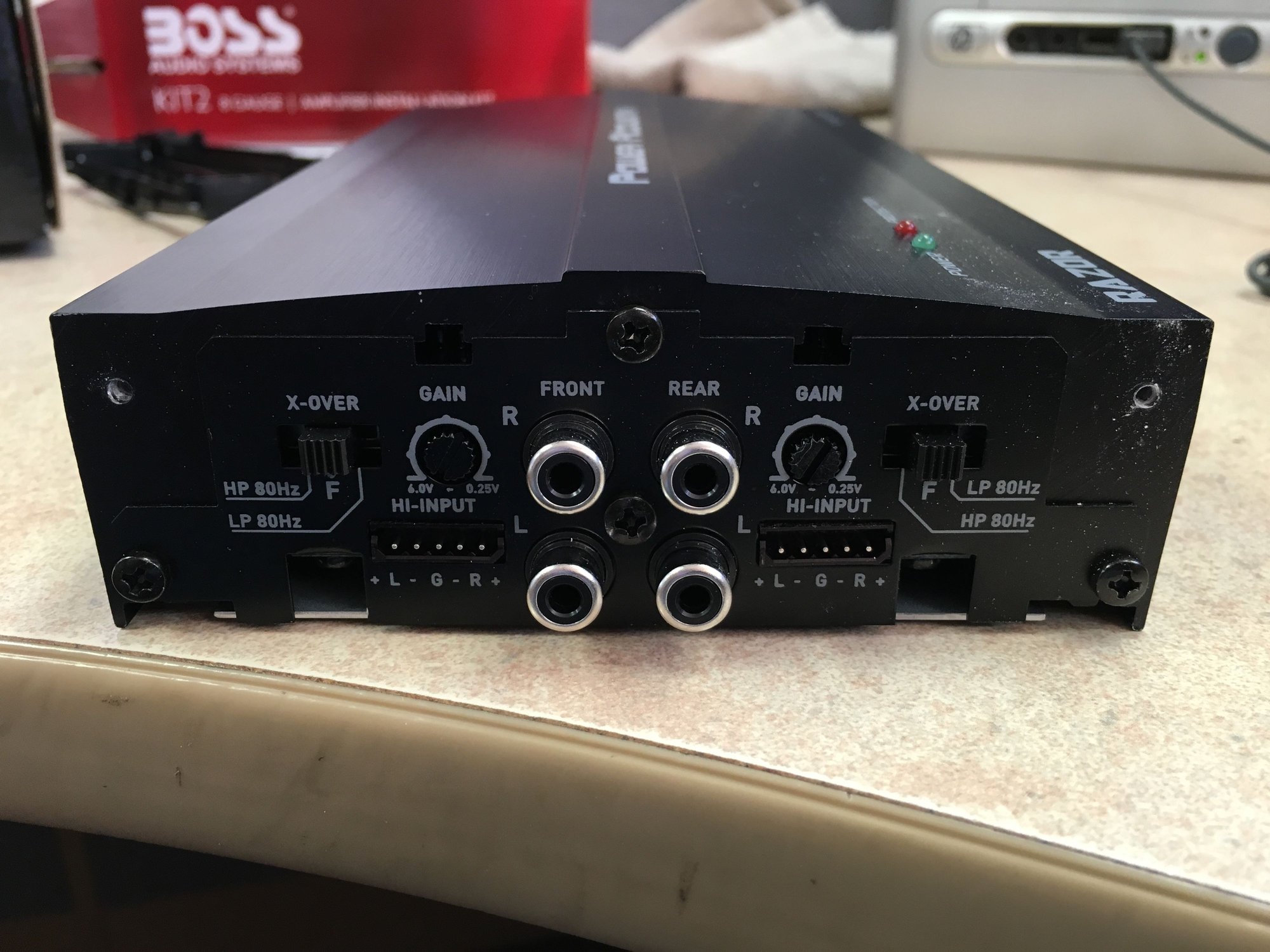

Ok Gannicus, amp and install kit arrived today, speakers will be here Friday. I took the handles off for something to do....got 1 question, what the hell is all this? Lol

Lol. . . A bad *** amp bro. You are going to need some 1.5" RCA cables and some 16 ga speaker wire, some 8 ga power and ground wire and a 40 amp inline fuse. You can purchase it locally or order this kit from amazon.
Amazon.com: Boss Audio KIT2 8 Gauge Amplifier Installation Kit with High Performance RCA Interconnect and Speaker Wire: Car Electronics Amazon.com: Boss Audio KIT2 8 Gauge Amplifier Installation Kit with High Performance RCA Interconnect and Speaker Wire: Car Electronics
Also need 6.5 speaker adapters if you have not gotten them already.
