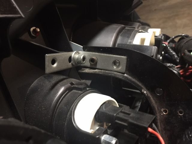

Totally agree with Bates! Been there done that. The pic below is how I fixed mine:

No repair. All you can do is reinforce the bracket or purchase new brackets which are cheap and flimsy. All you can do is make the one you have better. As you stated "very poor design"
