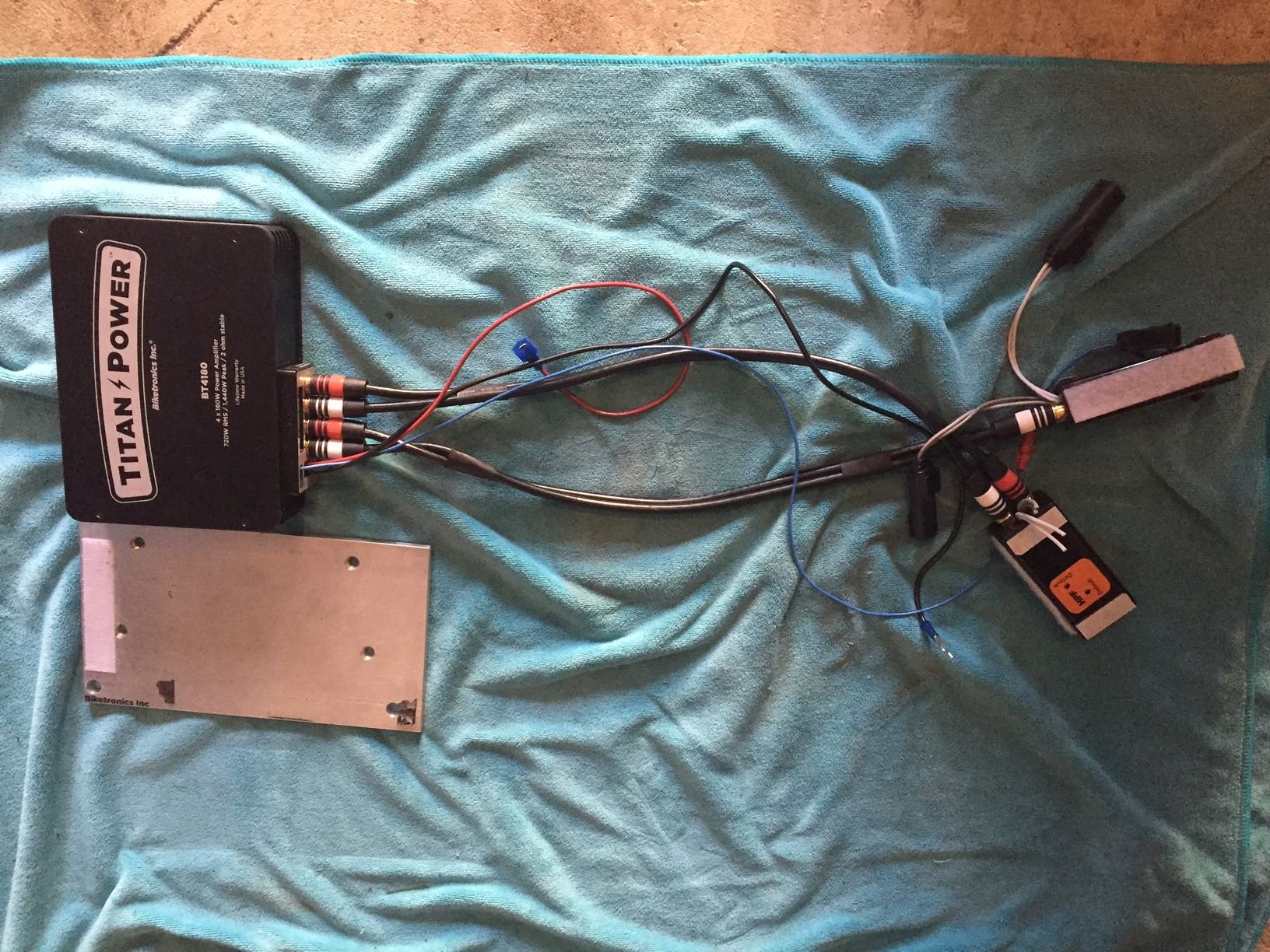

I've had my BT4180 installed in my 2015 SGS for several weeks without issue, then today after a ride the radio won't initialize. It will try to come up to the accept/warning screen, and when hitting accept it promptly goes to the clock/logo (like it's off). Weirdly, the volume hand control registers across the screen (no sound) the info button brings up the temp. EITMs etc. What I've done so far:
Fully charged battery,
Disconnected and reconnected the battery,
It has the latest firmware.
Next I'm pulling the fairing to check wiring and connections, but wonder if anyone else experienced this and has ideas?
Thanks!!

Gah, talk about frustrating. Pulled the amp and ran direct to speakers, and radio still wouldn't initialize beyond the warning. Ride to work. Call and get an appt at dealer for NEXT week. No radio/bluetooth/nav...still.
Get ready to ride home and all of a sudden everything works again. Thoughts? Call Biketronics, reinstall the amp? Go to dealer and see if there are error codes in the history?
Almost ready to ditch the aftermarket and go with HD Boom upgrade, at least then I wouldn't be pulling the amp and wondering if whatever happened to the radio will be covered by the warranty.
