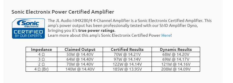

I'm going to warn you, that 280/4 is a cool little amp but powering 4 speakers is going to be a challenge for it to get any high volume of sound. You'd be much better served with the 500/4 if you can return the 280/4.
I'm using a 280/4 bridged and it's kicking out about 180 per channel bridged.
If your stuck on the 280/4, you could run some 2 ohm speakers (it dyno's out at around 120 x 4 @ 2 ohms) but that kinda limits your choices. Maybe the Polk M651's (you'll get close to 100 watts @ 2.7 ohms on the non UM version).
In either case, you'll want to use at least 1 BT 355 Line Leveler. You can run only the front channel into the amp and the amp will split the signal but you will have no fader. If you want the fader option, you'll need both the front and rear Line Levelers.
There are other options to not use the Line levelers, but for ease of use and something that just plain works I'd STRONGLY advise using them.

forgot to add the graphic of the dyno on that amp
