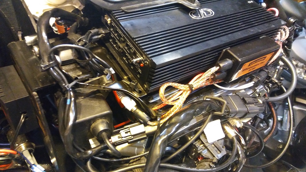

I ended up not modifying the stock tray. It's a tight fit but it did work.
You cheated with the zip ties lol. Looks good though. I only cut things since I already cut up my stock tray for my Fix86.
