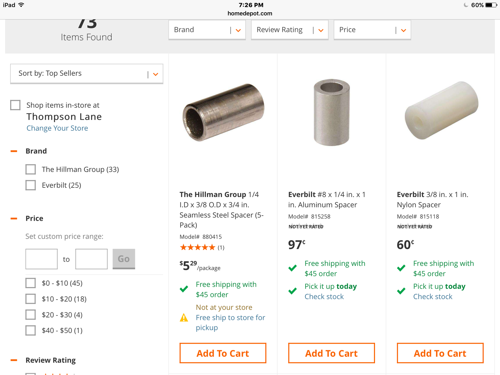

Old Feb 14, 2017 | 07:31 PM
tesnevo's Avatar
tesnevo
Joined: Aug 2014
Posts: 917
Likes: 95
From: Nashville, TN
If you drill and mount to the front/curve you can get spacers at Home Depot to compensate for the curve. You want to keep the tourpack from getting straightened out when you mount it to the fiberglass. They come in all different sizes to accommodate for the space needed to keep it mounted flat.
