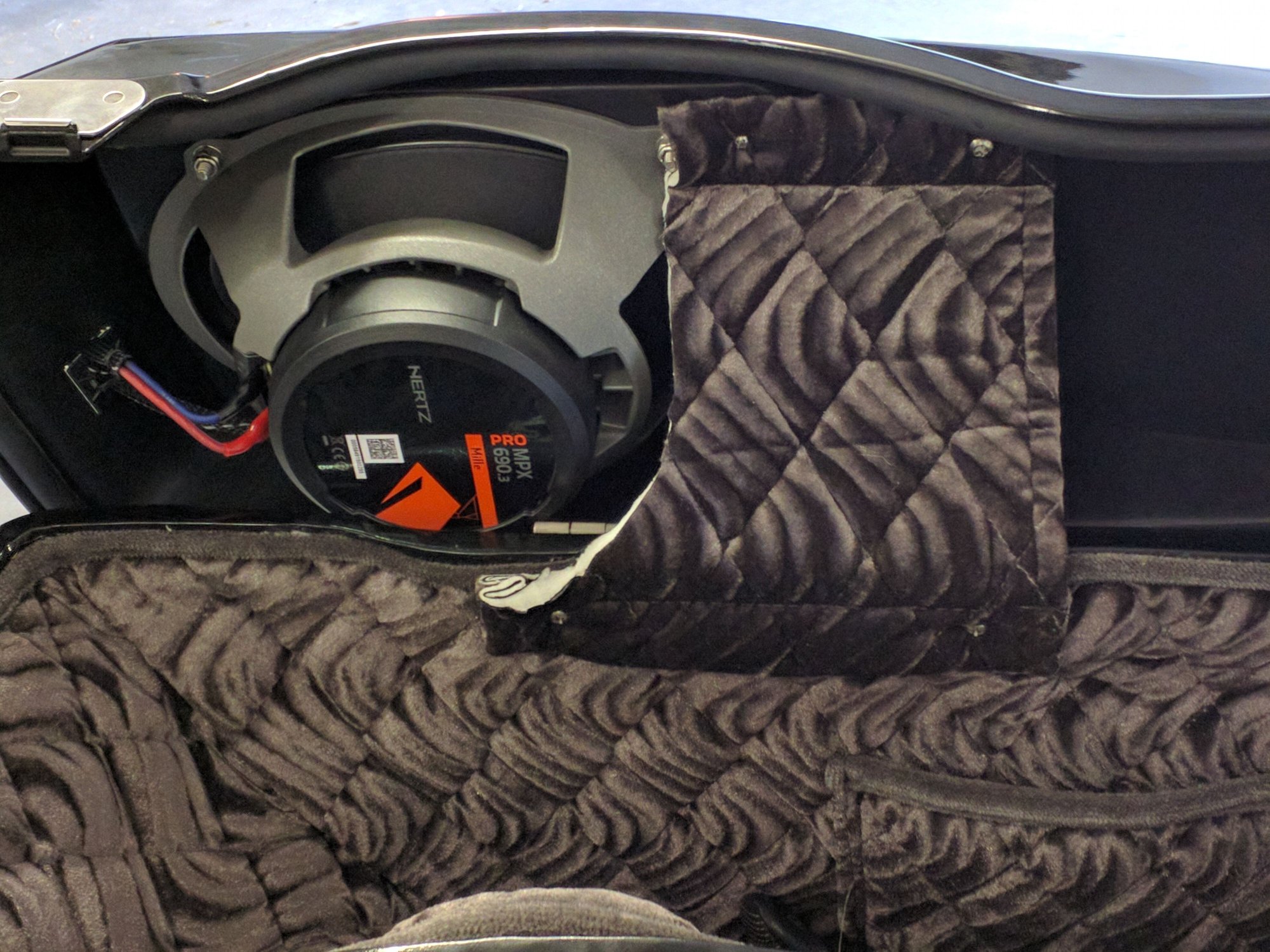

Needing some advice on these. Ordered some speaker lids and nothing came with them but the lids themselves. I've googled and coming up with not much of anything. Lids are on my 2012 Street Glide

Just trim your factory tethers around the basket of the speaker and you will need to find a mounting point for the metal strap that slide in the tether. The spacing will need redrilled for at least one hole on the 6x9 side. Will look somewhat like this.
