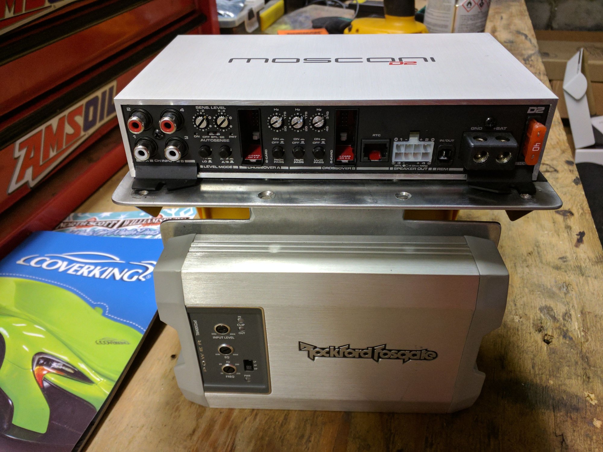

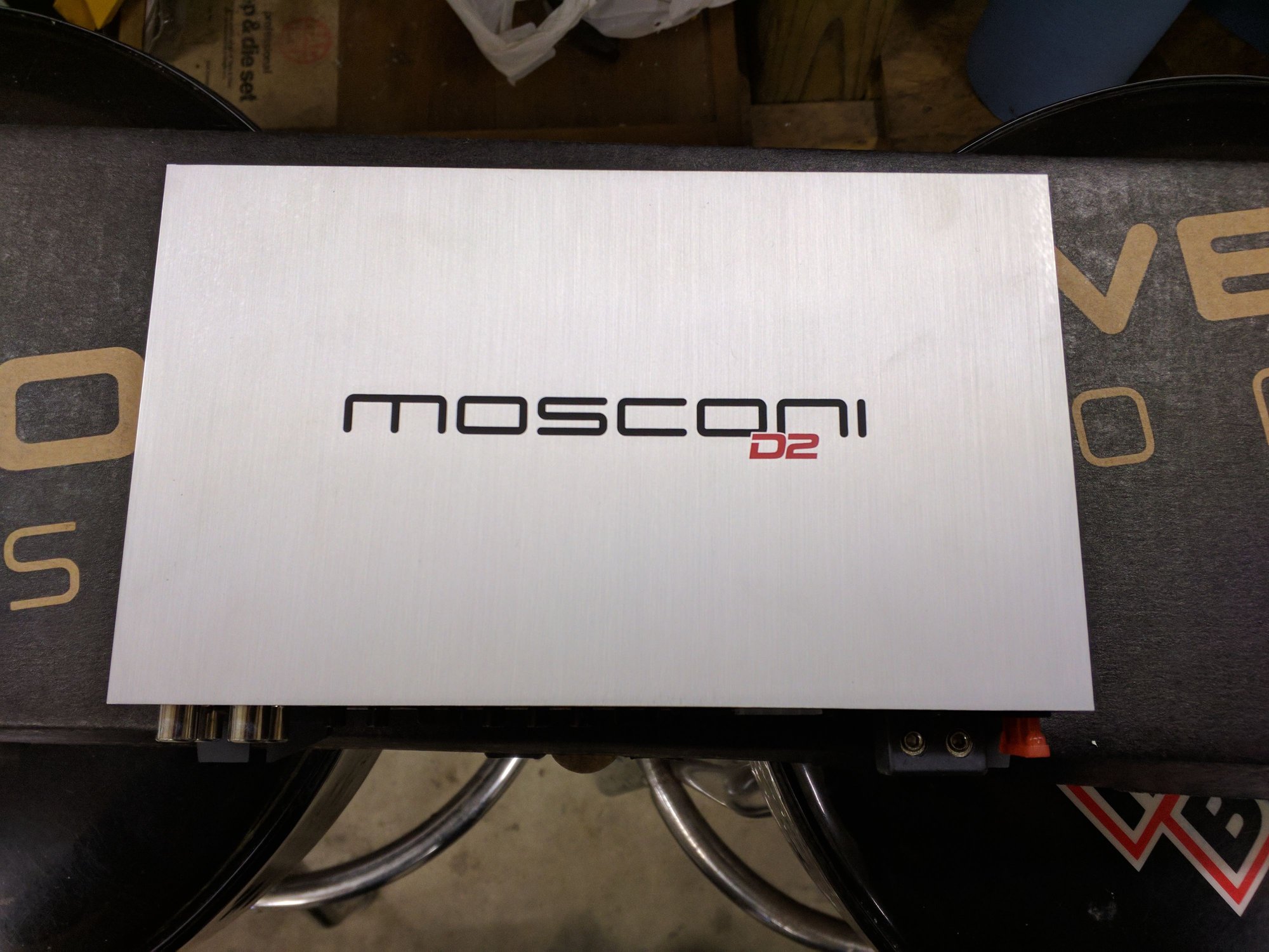

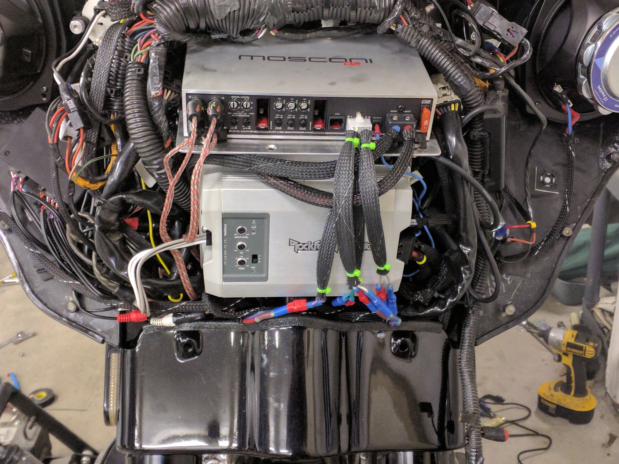

This will be a fairly short but well informed. I will start by saying this amp is phenomenal. The output is clear, vibrant and punchy. On a 4 ohm resistive load I pulled 140 rms per channel before the scope sawtooth began. The amp fit well under the fairing on the mount I had fabricated and used on my last few amps. I do not like not having screw terminals vs pre wired leads I have to solder to or add quick connect to. For the cost it should have screw terminals for the speaker connection. For a $999 msrp amp, I can say the performance and quality is there. Especially like it being made in Italy vs China, Taiwan, etc.
Current draw is low and is very efficient. Gains are extremely sensitive. All in all I can not recommend this amp for one reason. The cost. For what else is on the market with similar specs, the quality and build design just doesn't justify that price for what else can be had. If the cost was down closer in the $600 range then we are cooking with peanut oil.
