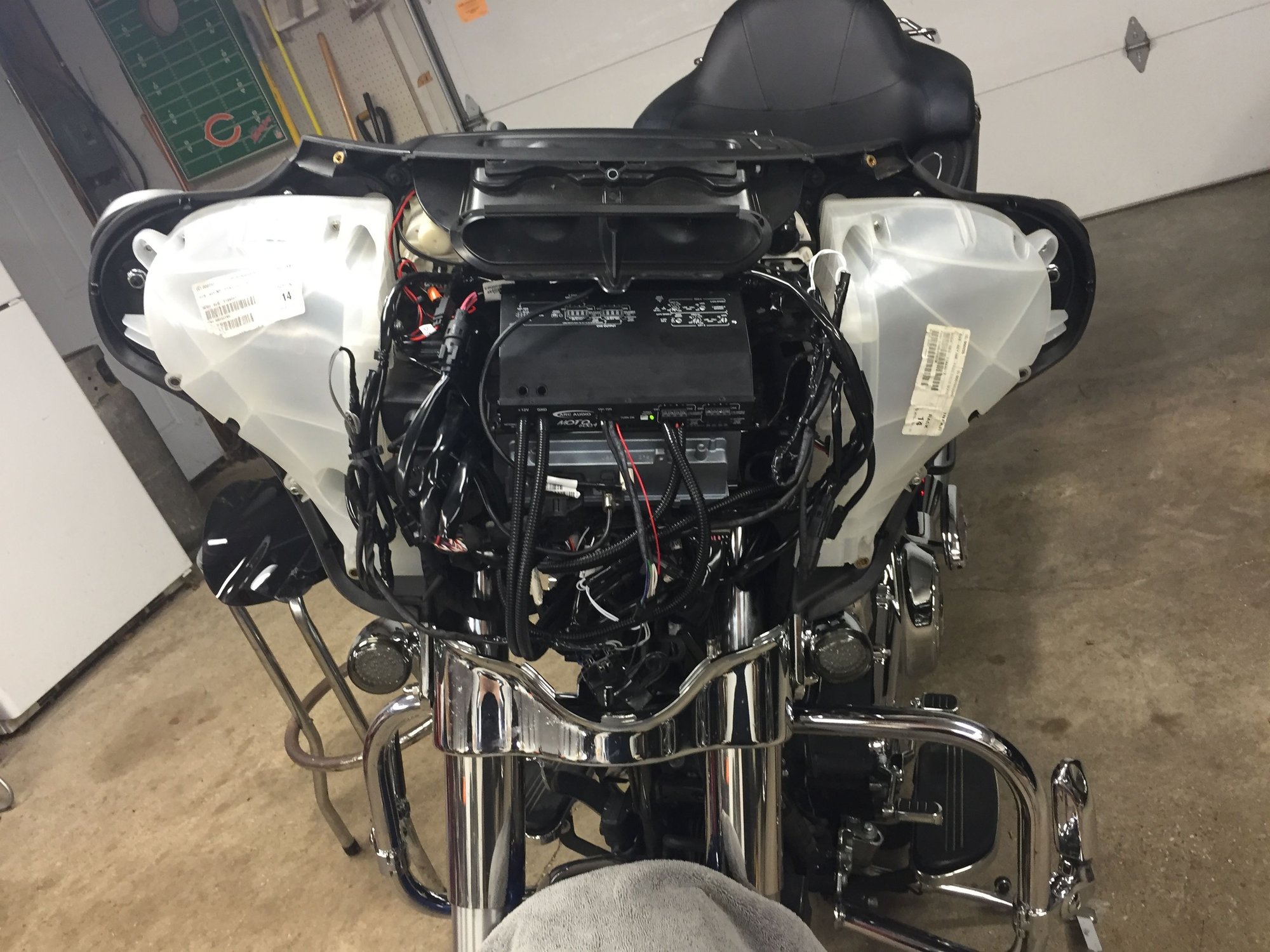

As for the aluminum I used (don't laugh) it was an old street sign from the Chicago CTA. The thickness is unknown​ right now as I am at work an unable to measure the material.
To bend the 90s I have a homemade sheet metal brake I fabricated at work I use.
For mounting the bracket I slotted the bracket to slide down over the side mounting bolts for the HU.
Hopefully this will help
For mounting the amp to the bracket I used industrial velcro. The stuff sticks so good you have to use a screwdriver to pry it off the mount

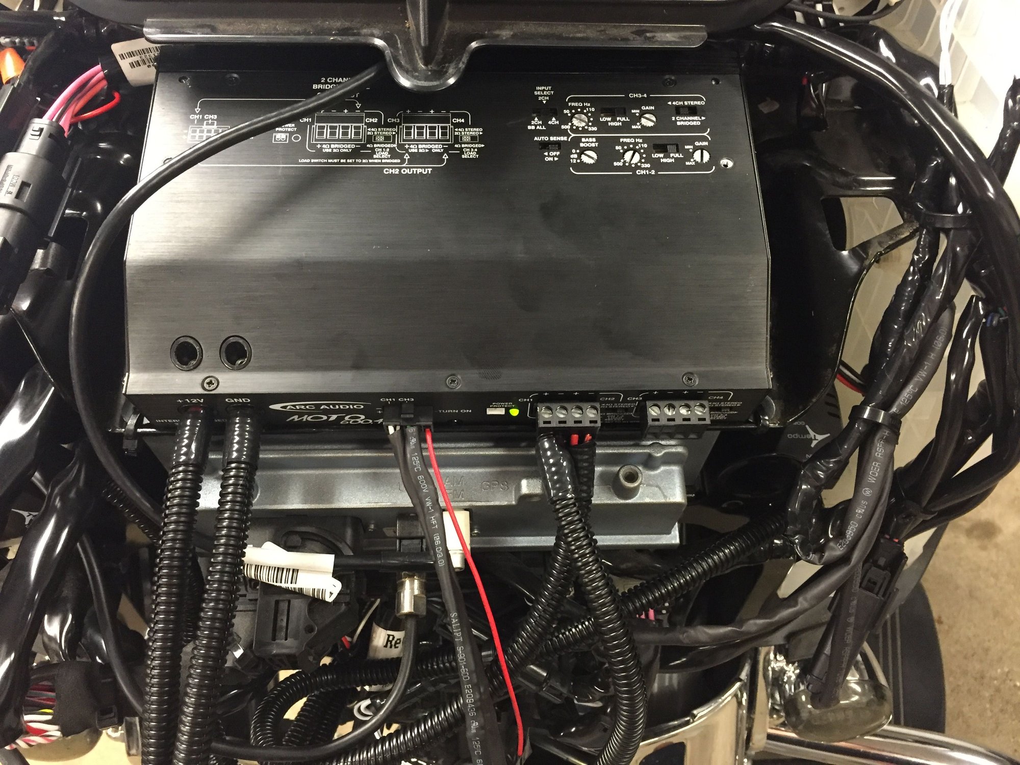

Here's a pic of a 2013 w/stock HU n Arc Moto 600.4 amp.

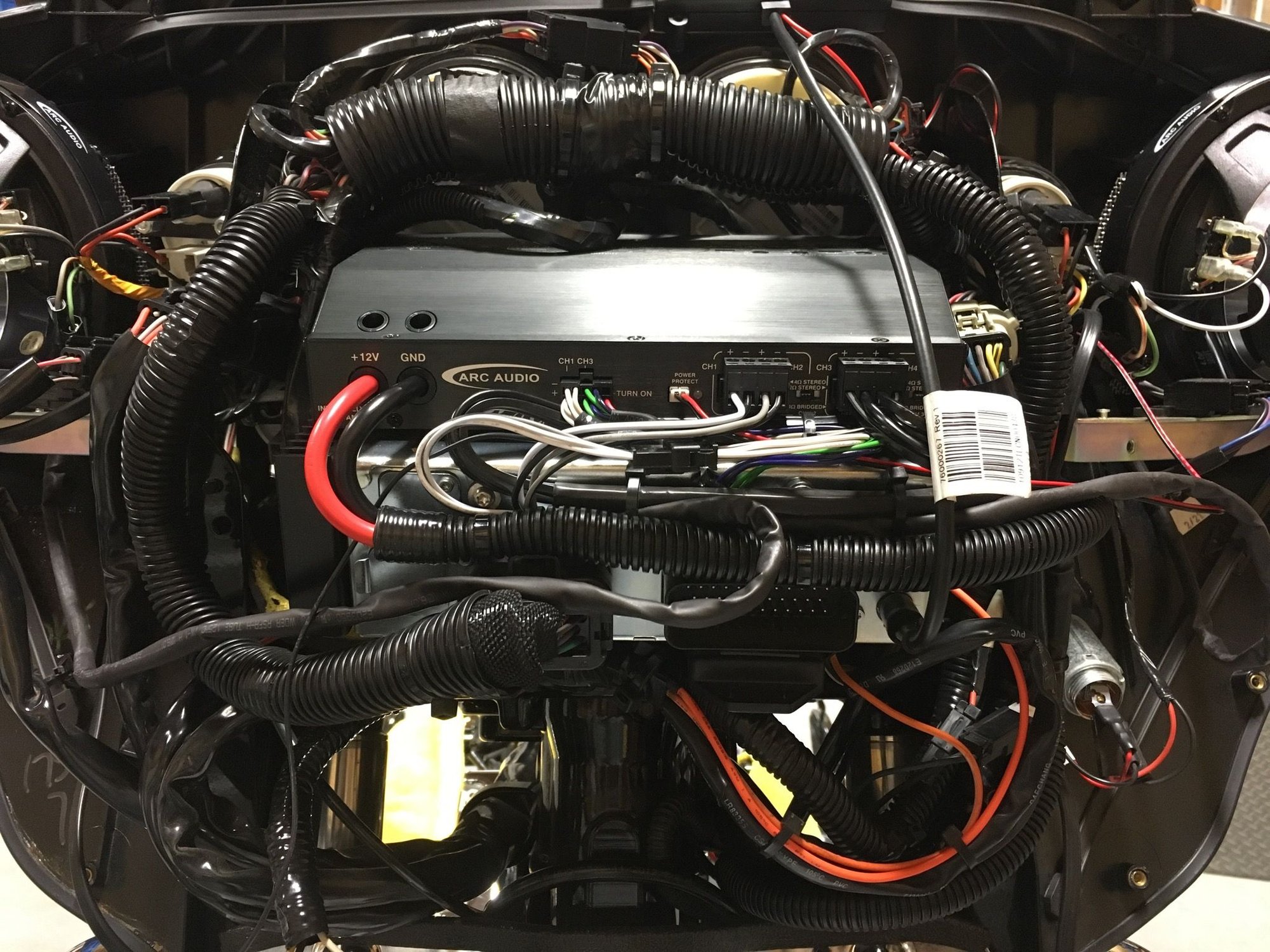

here are a few pics from my 2015 sg

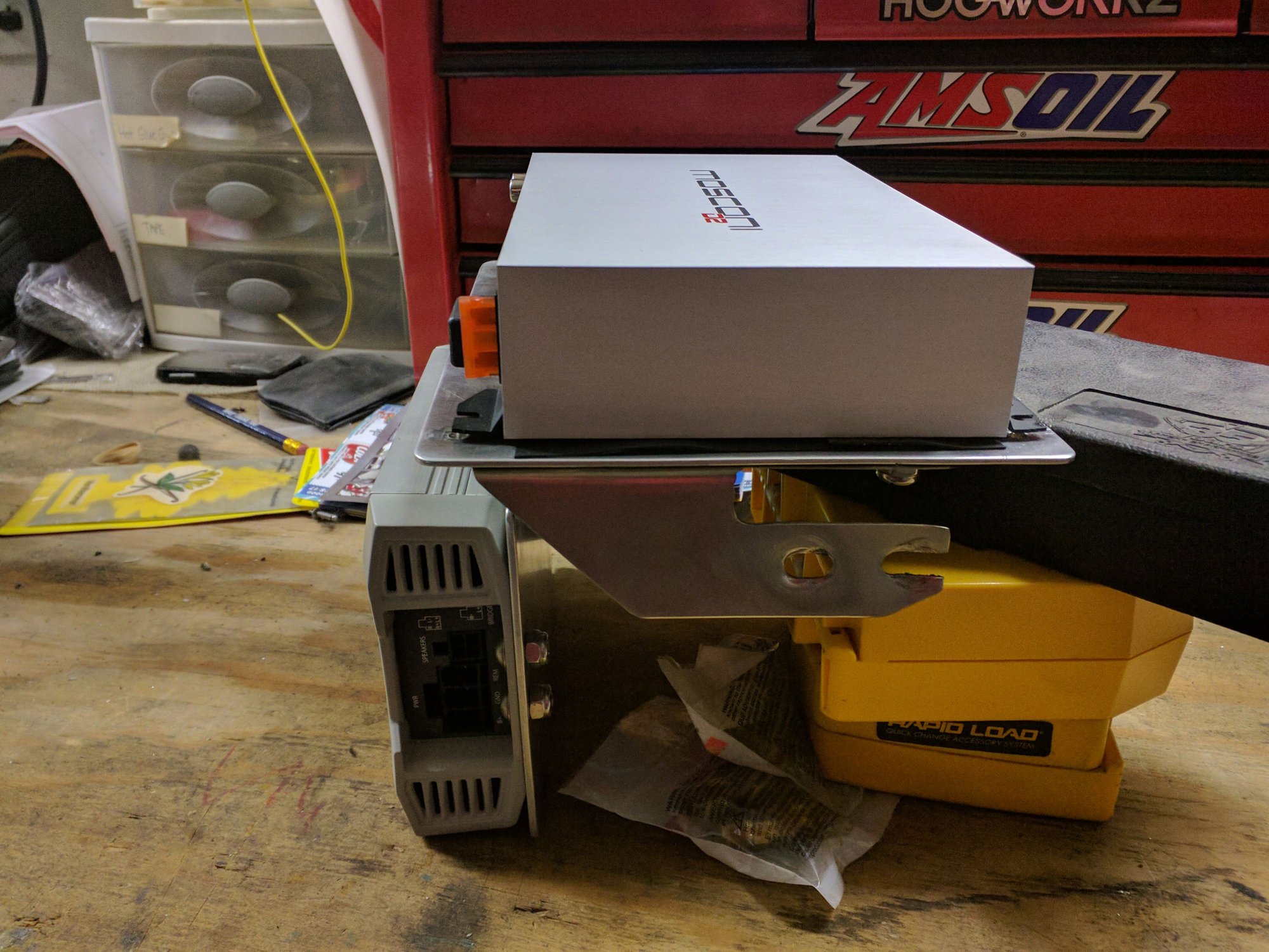

Same mount on both amps. .090 aluminum on plates, and stainless is 16g iirc for the radio mounting point.
