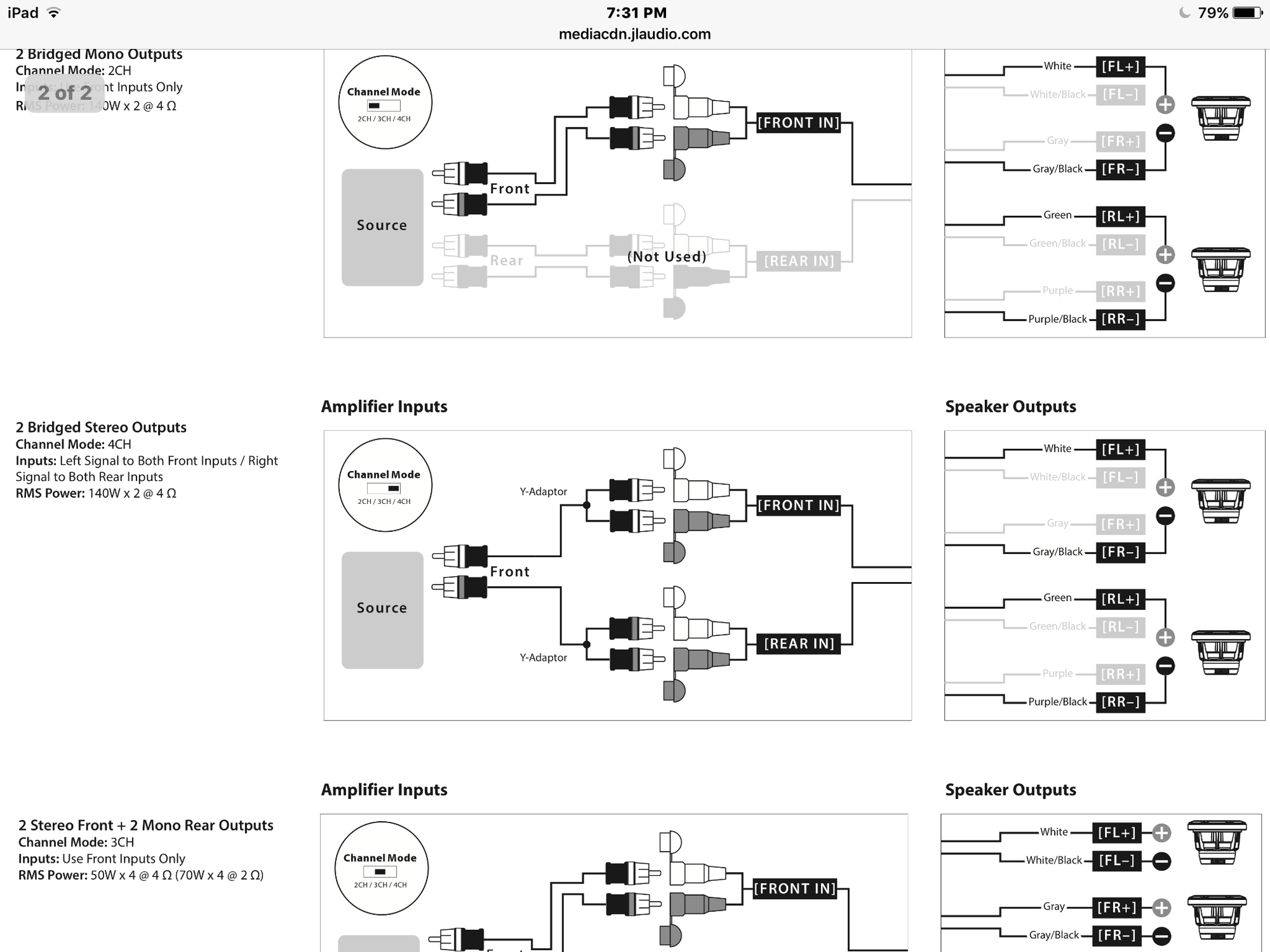

Old May 1, 2017 | 07:34 PM
tesnevo's Avatar
tesnevo
Joined: Aug 2014
Posts: 917
Likes: 95
From: Nashville, TN
Follow the middle diagram exactly as it shows. I'm assuming your bridging the amp so you will need to feed both rca inputs with a "Y" rca as pictured to get stereo to all 4 channels.
Old May 1, 2017 | 07:49 PM
bobbyjoes's Avatar
bobbyjoes
Joined: Dec 2008
Posts: 671
Likes: 7
well for now using just 1 LL, untill i get it flashed, i got the left working good nothing from right i checked connections, hell i dont know
Old May 1, 2017 | 08:46 PM
bobbyjoes's Avatar
bobbyjoes
Joined: Dec 2008
Posts: 671
Likes: 7
i got it ,i had everything right except the lines coming out of line leveler,got on the phone with T and he walked me through,thanks to all who help,got to clean things up and tie stuff down,put some dynamat on fairing and this project is about done ,thanks again for the help,sorry i was so slow,ha
