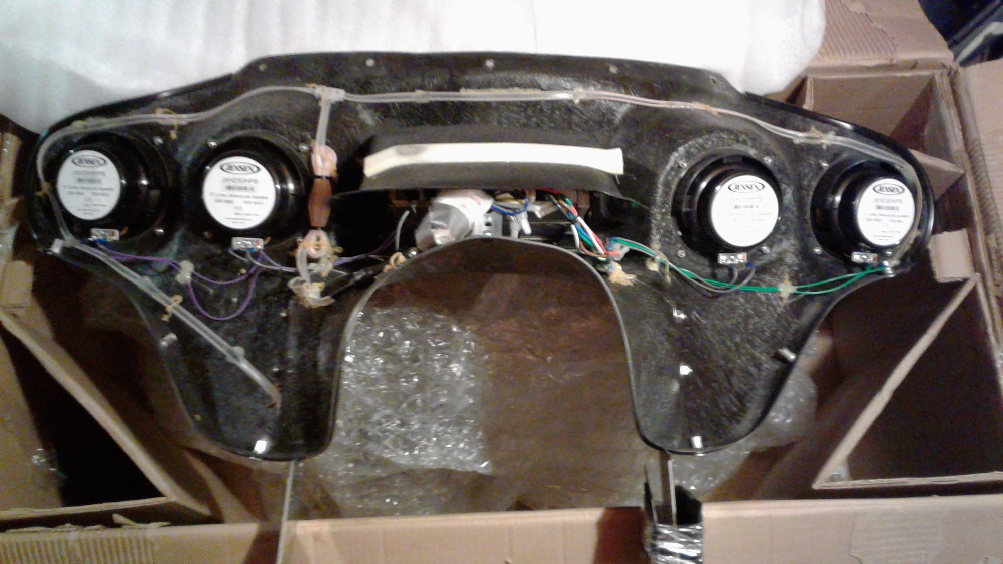

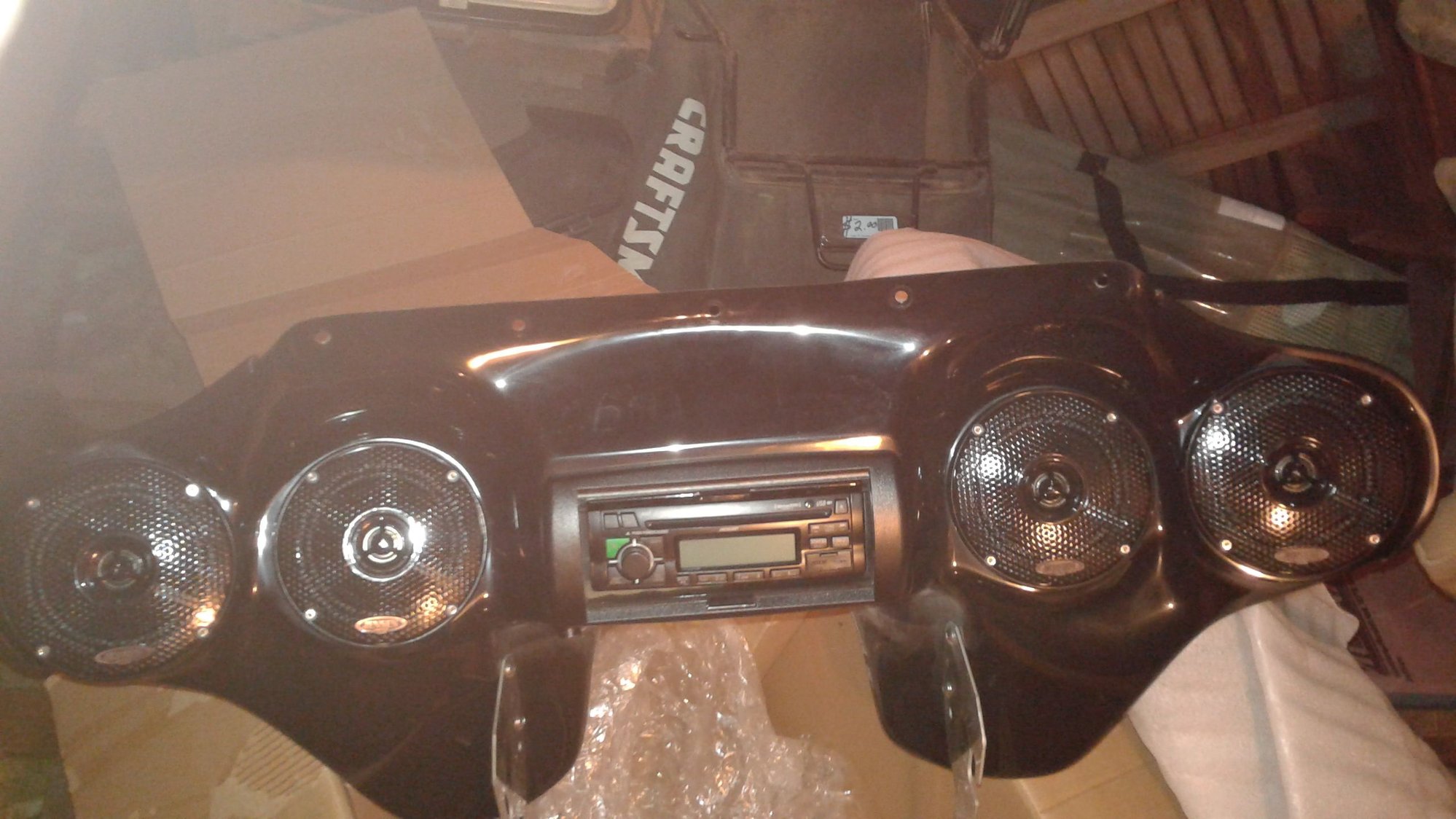

Old May 30, 2018 | 08:22 AM
trigger1911's Avatar
trigger1911
Joined: Jan 2007
Posts: 310
Likes: 39
Here is the inside of the Hoppe Quadzilla fairing. There is not enough clearance for 5.25 speakers because of its design for mounting or clearance of the magnet for the outer fairing.
