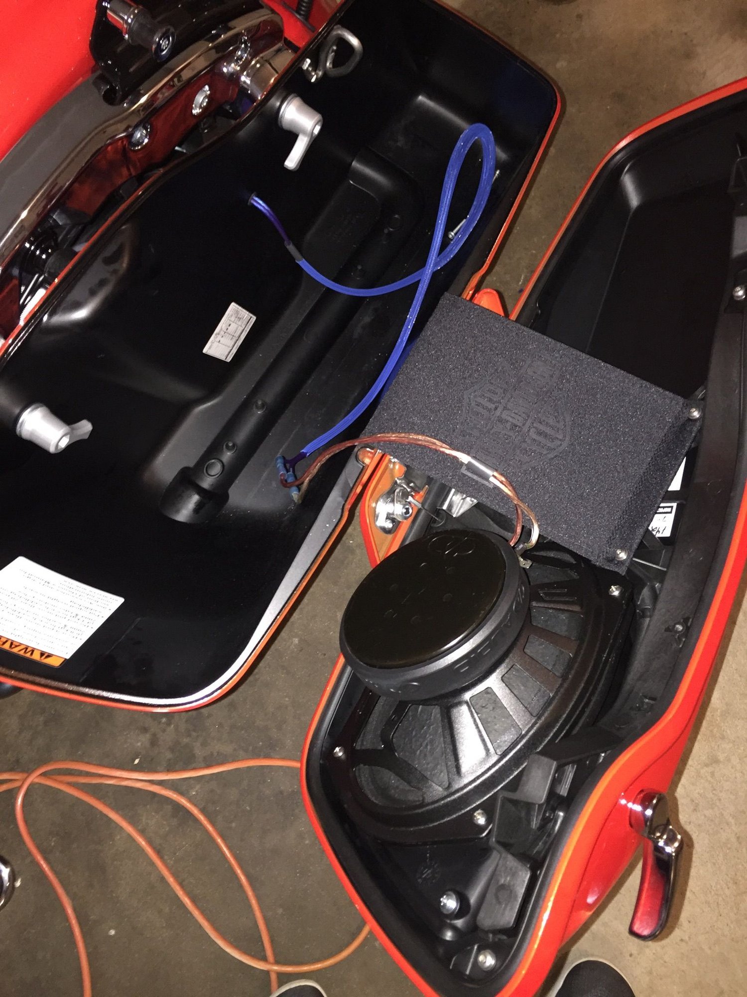

just made my final parts purchase on amazon, install going down this weekend. many thanks to alex for hooking me up on the components while having his hair on fire with SOS. In the process I spoke to the folks at BT and Arc and they were both super courteous, informative, and helpful. this is where I landed:
DD AW6, AT28, VO6x9, arc moto 600.4 - BAL
BT355
arc audio mount, power wire, and harness
6x9 adapters AHB
lids - HD, they showed up in 10 days painted :-O
Delphi connectors for tweets and saddle bags
stinger wire and 8000 series RCAs, got a sweet deal
neon blue braided sleeving, I know you cant see it, but I know its there lol
let me know if I missed something. I toyed with the idea of dynamat, but passed since I will still be using the road glide pods. I can always go back for that easy stuff.

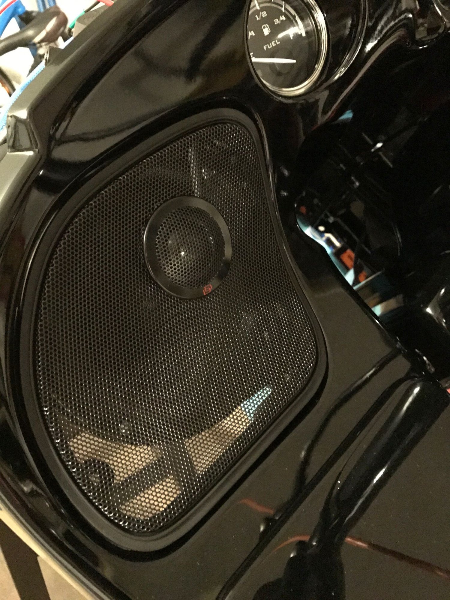

Default Making progress

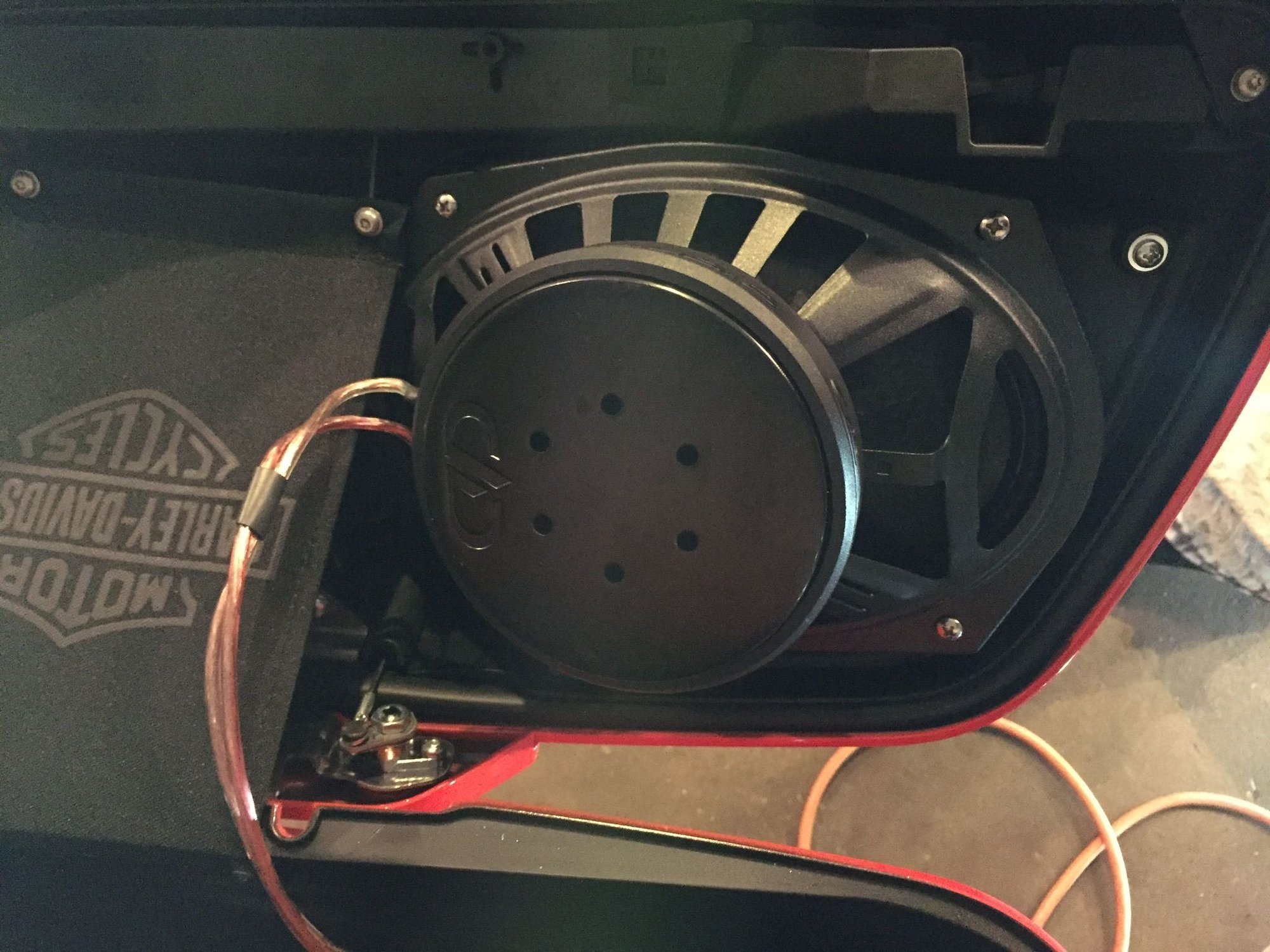

Default Bags

Default Scope creep
