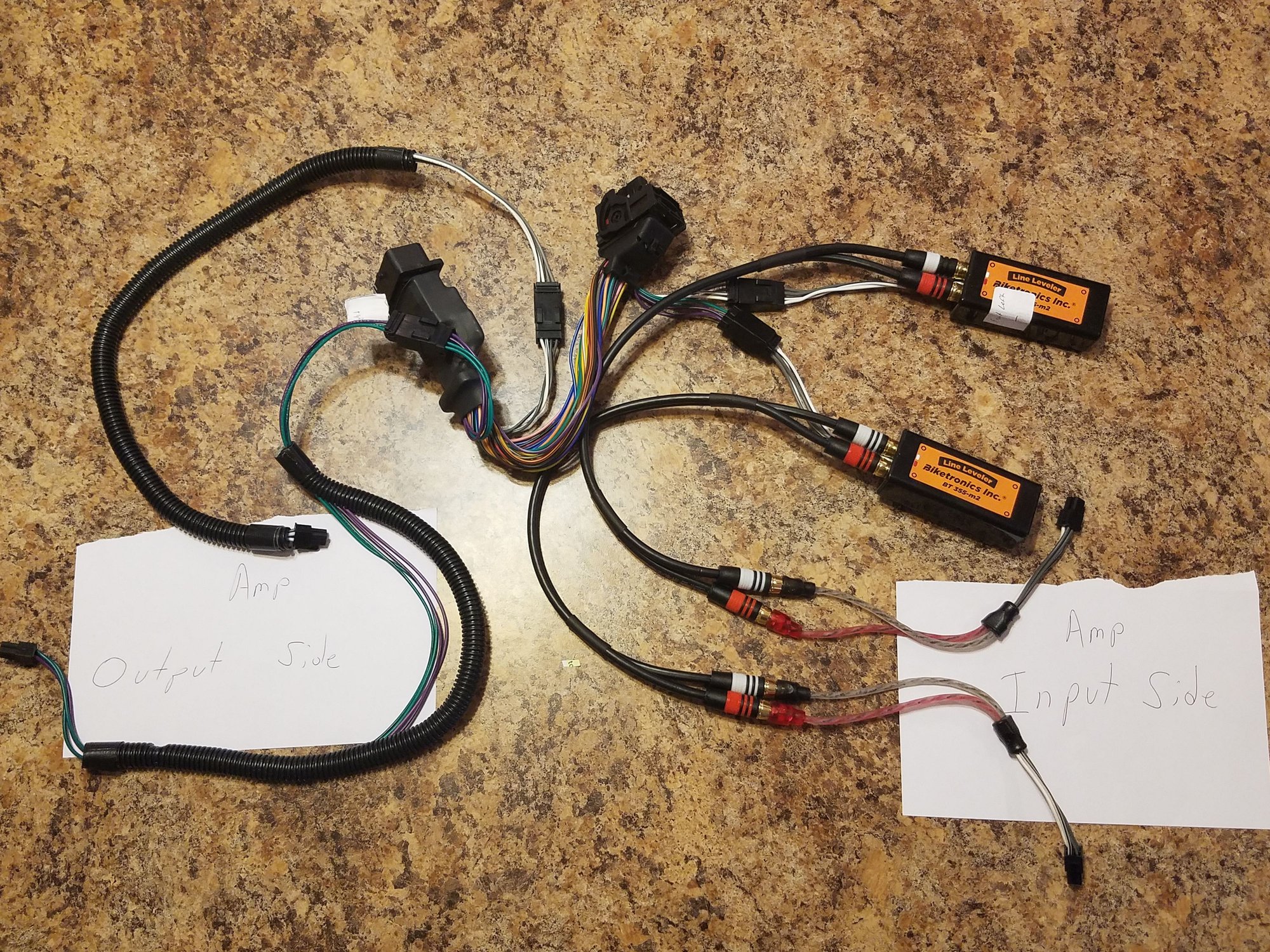

Hey guys, after reading many of the reviews on here I decided to pull the trigger and update my sound system on my 2017 Ultra Limited. My added components are:
Cerwin Vega B54 Amp
VTTO14 Amplifier turn-on wire
4 Infinity Kappa 62.11i speakers
Biketronics Breakout Harness
After installing the breakout harness, there is no sound! So I unplugged the breakout harness and plugged the factory harness back in the radio and there is sound again. I do have power running to my amp I'm going to call Biketronics on Monday but was just curious if any one else had this issue?

Where are you plugging your line levelers into off the breakout harness? Is it possible that upon hooking up the BO harness, that you left your line levelers plugged into the stock speaker plugs? This would explain why it works when stock connection is plugged in any why it doesn't work when the BO is plugged in. The breakout harness has 4 plugs on it, your line leveler plug will only plug into two of them which replaces the stock plugs that you are using without the breakout harness.

He's not getting signal to his amplifier with a BO harness attached but he is getting signal with it out. His problem isn't on the output side of the amp, it's on the input, i.e. where are the line levelers plugged in.

This is how i had it ran, per the instructions

Also, I never messed with the LL settings. Just hooked them up straight out of the box.

That doesn't jive. Wtf is going on.

I tried to do some troubleshooting today and bypassed the amp by plugging the BO Harness inputs and outputs in together, which produced sound. Would this mean that the problem is with the amp?

That is entirely possible. This is probably a stupid question but are you sure the amp is powering up? Are you using a remote turn on wire?

Possible too that the BO harness is bad. I know I sent one back for a similar issue.
