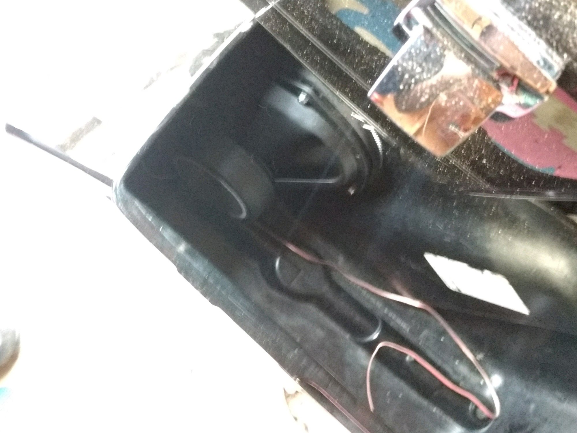

Whats up forum. So I started my setup on my bike. I had a bunch of extra audio stuff laying around the house so I decided to put me a lil something together just to make her sound better then stock. Started out with replacing my stock inner fairing speakers with some Sound Ordnance 6.5 component speakers with crossovers and tweeters. All this off the factory head. Then I added the Alpine KTP 445U power block for the added boost. Got her tuned and was sounding great. Wanted a little extra and I had some Polk audio 2ohm RA 6902-1 6x9 subwoofers sitting around and another 500 watt amp. Didn't have speaker lids so I went with installing them in the bags since these are subwoofer style not 2way or 3way 6x9s. They are for bass period. Got it all wired, tidy, and tuned and I got to say I like it. I may have to add another set of crossovers and add some mids or high's to the back as well just for extra clarity. But just off the fronts for the clarity and the bass coming off the back it sounds soo good. Its nothing that will win a competition for SPL or anything but I love it.
Old Nov 20, 2017 | 12:00 AM
ajclassic's Avatar
ajclassic
Joined: Aug 2017
Posts: 214
Likes: 79
From: Maryland
6x9 in bag
perforation on the inside
Here are a few pics of the install. I do have screen between the bag and then the spacer, and then the speaker all sandwiched. I used black allen head bolts, and nylon lock nuts. Flush mounted so that nothing sits out on the inside of the bag. under seat wired
with the seat on you really cant see nothing. To me a clean install.

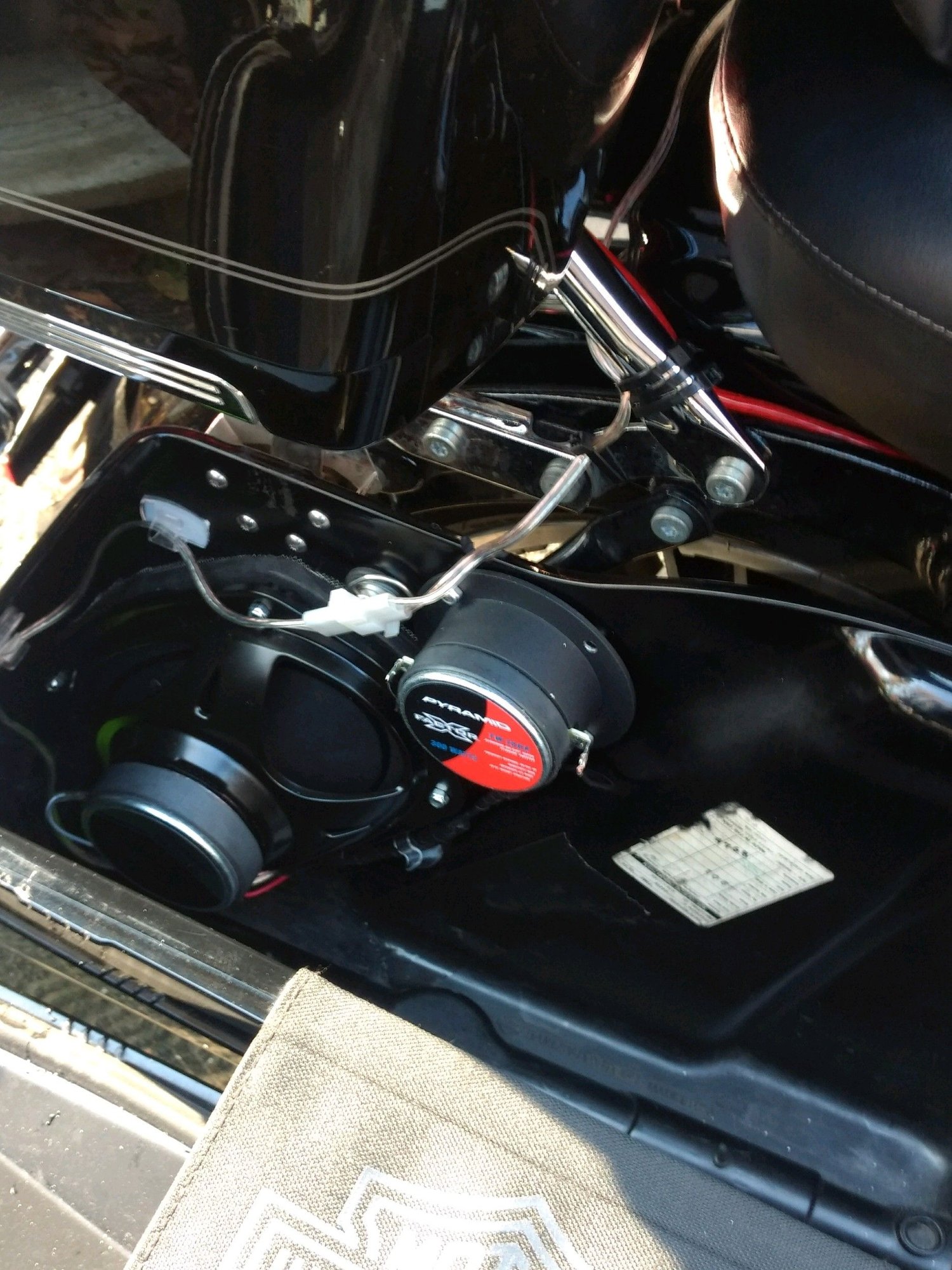

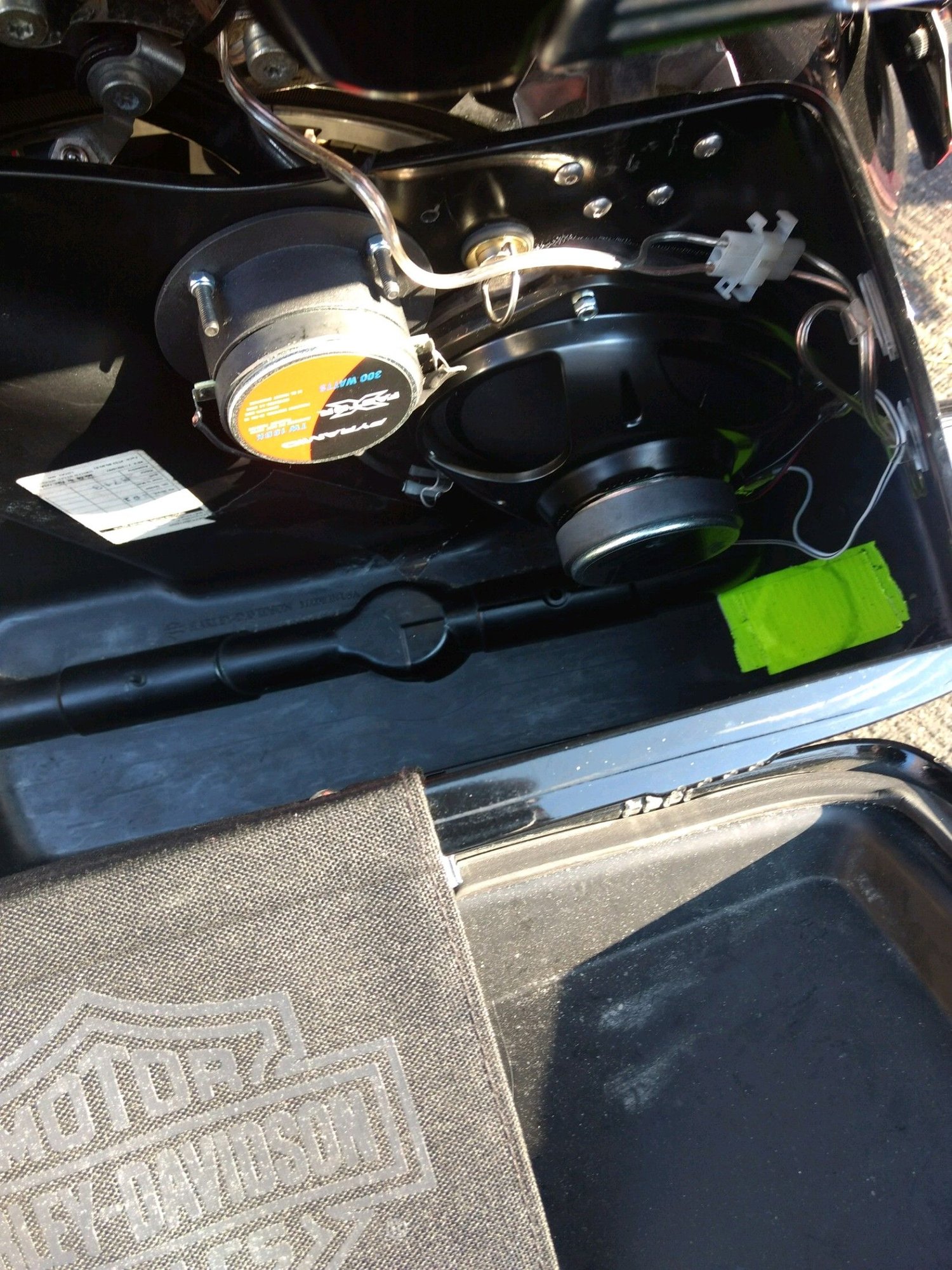

So i swapped out my subwoofer polks, for some pioneer 3 ways and a set of tweeter horns. Running both parallel per channel its plenty of power going to them and they sound even better then the subs because of the extra clarity. All i really have to do is either tape wrap the wires or get some loom. But Im satisfied for now. LOL... Oh and dont mind the missing bolts. That was the mock up and test for sound. I have since bolted it all up and tidy'd the cables.

i know you're just using stuff laying around the house but IMO if you're going to put in that much work. You should go ahead and do it right using tried and true components that work well on our bikes. The class AB amp will eventually cause you problems. With your obvious skill and ability you could really put together a nice system.
