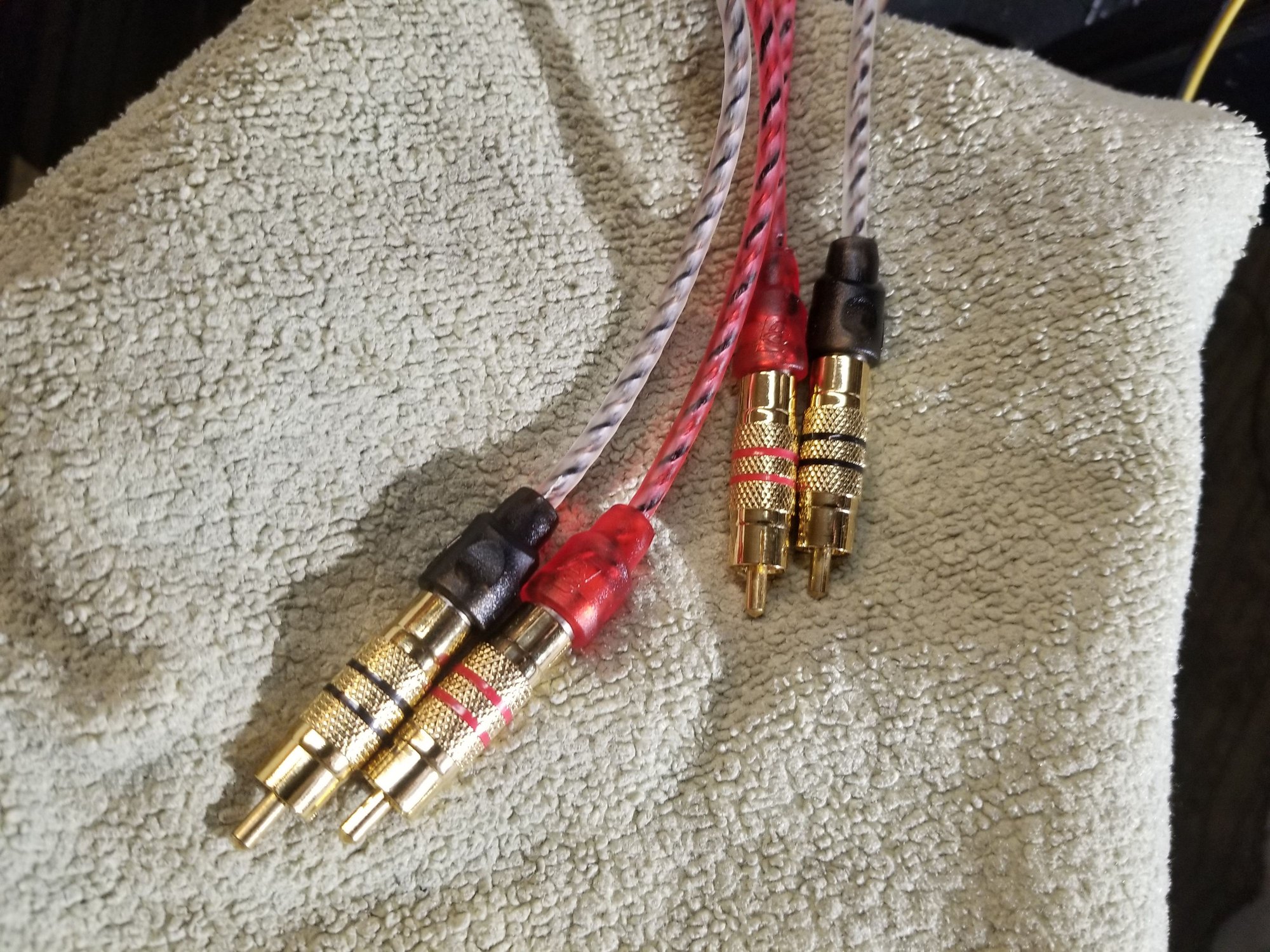

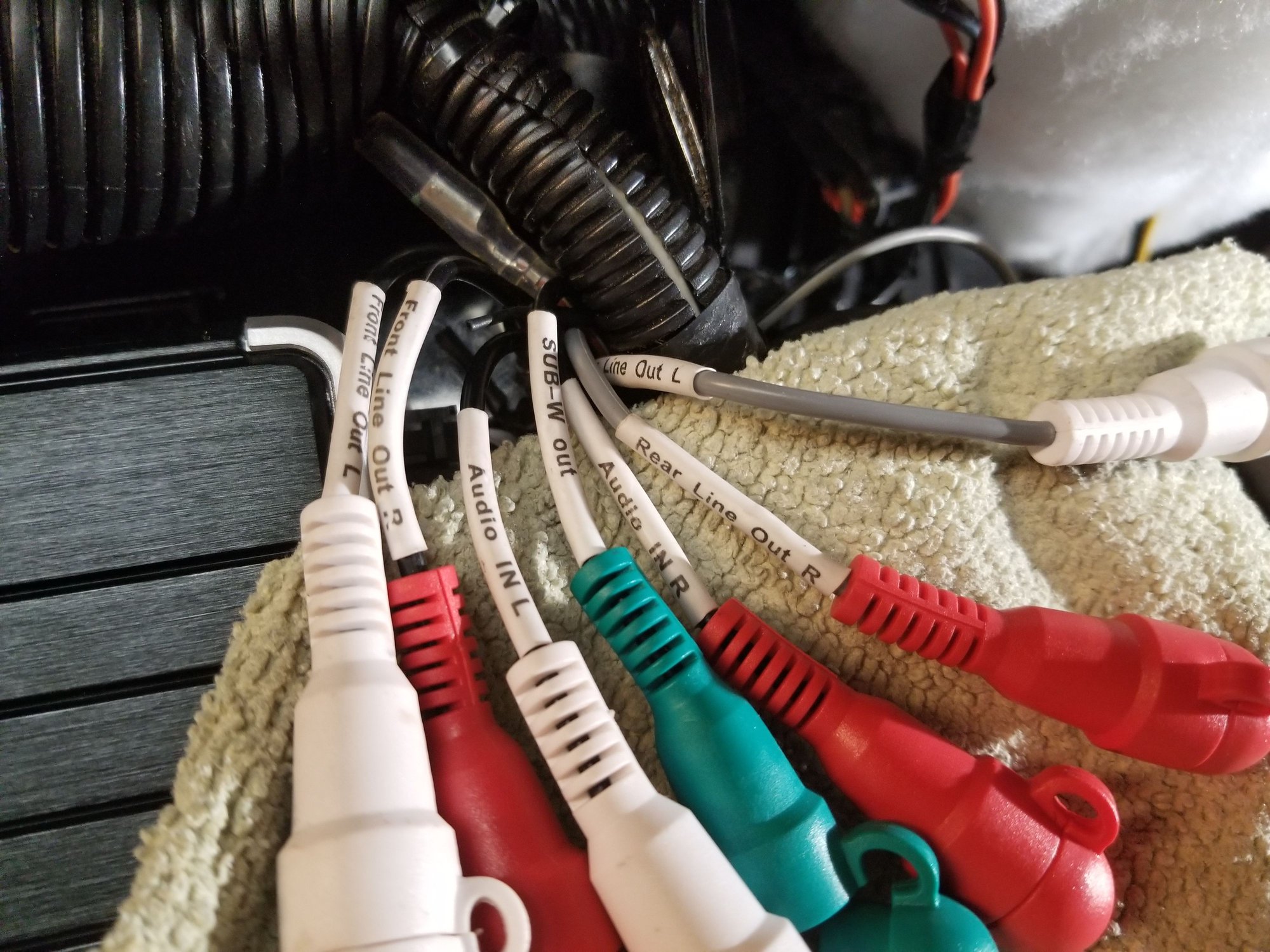

Last request for assistance. I'm confident on the speaker hookups but now need some help with the RCA connections. I'm only running two fairing speakers so do I need to connect all 4 plugs or just two? Either way, I need to know which ones of those available do I use?

RCA's from the Cerwin Vega B54 amp (left and right side plugs).
RCA's from the Aquatic HU.

Use the RCA plug on the left side of the amp and hook it to the front output from the HU. You'll need to connect the blue remote wire from the HU to get the amp to turn on. Hooks up to REM on the amp.

So I'm only using ONE of the male/male RCA's out of the four I have and only connecting to ONE female in the bundle?

Yes you'll have to cut the end off but make certain that it's the remote wire. On the HU you have a red and a white front output. You will hook up to both of those and plug into the harness RCA's that plug into the left (front channels) of the amp.
