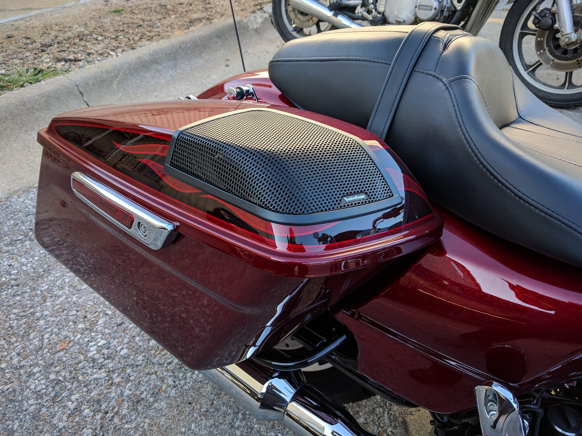

Kave Dweller is correct. The TMS69 RF speakers are 100W @ 2-ohm. I'm very happy with them, but an amp is absolutely required to drive them.

I don't think I could have cut up those lids.
It pained me, but I wasn't about to shell out $1400 for the H-D factory-painted lids for the speakers, and aftermarket painted lids didn't give me the warm fuzzies either. It's done.

I hear ya. I wouldve had a hard time cutting those lids as well but the end result still looks sweet and I bet it sounds great.
How much re-wiring is necessary if an amp was added? Is there a recommended amp for this particular setup?
