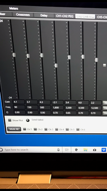

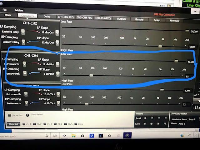

heres some screen shots of my settings
look at the plotter, I wonder if a higher slope would help?
Frenchie thank you for posting some screen shots. No knock on you or anyone who helped you out with this, however, this is pretty bad man. I get tons of folks asking me for tips and somehow it always leads to the same type of question “what speaker should I use” “ do you like this amp or that one” etc. it’s always product driven when truth is much of it could be fixed if what they had was set up properly.
let me guess you can help me out with a custom tune for $199?
No otherwise I would’ve offered.
What im telling for free is that your tune for those speakers is VERY wrong, and instead of spending money on speakers you should focus on fixing your tune. Good luck, nice cheap shot....I’m out.
