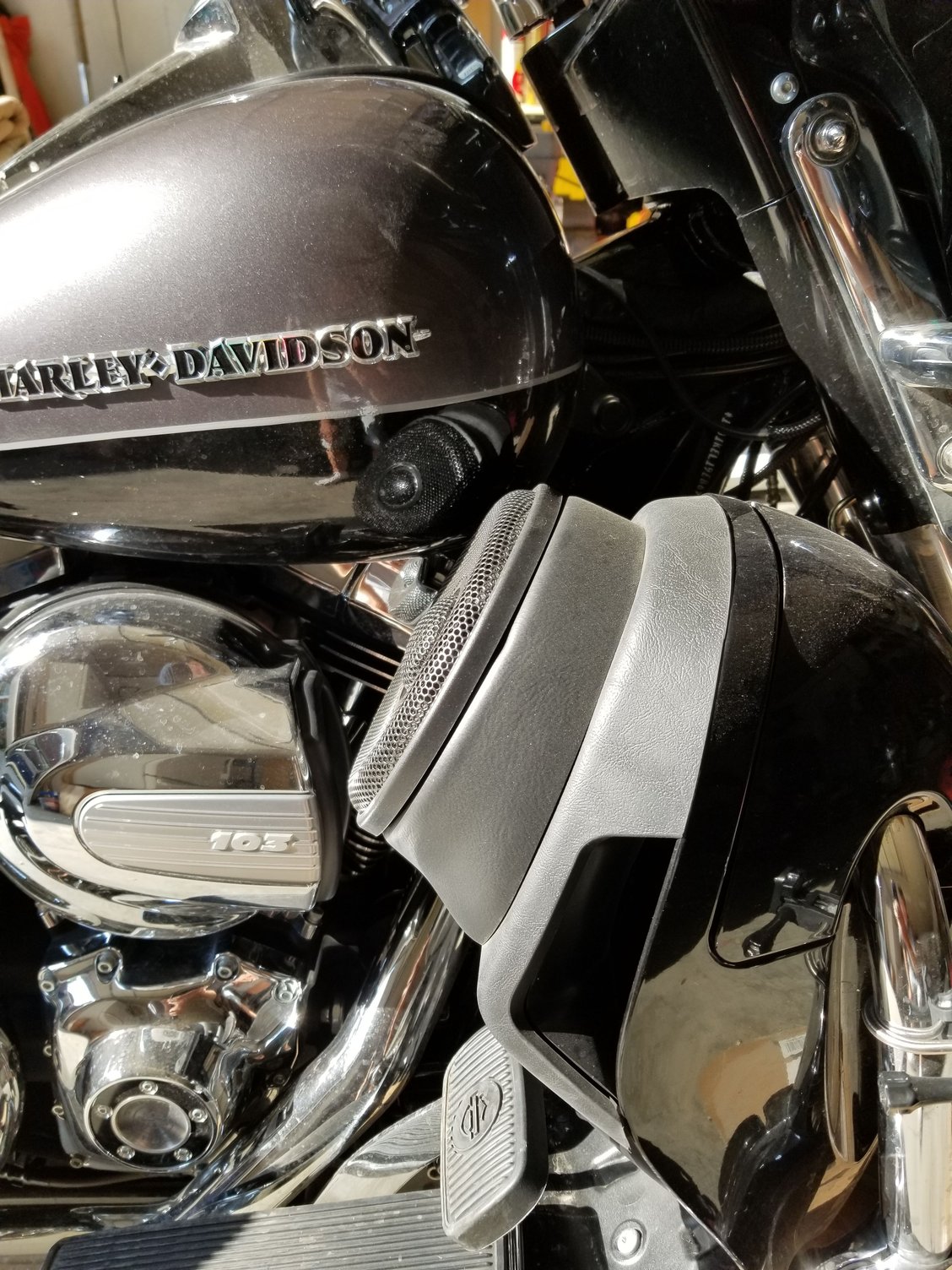

Here is a pic of the adapter that Soundz sells for the wethead lowers. It looks large and it is, but not in the way. I'm 6'2 and my legs don't get near the speaker. It's not much for fashion but it is for function. I figured I had 3 choices 1) No lowers 2) These adapters or 3)Sell the Limited and buy an Ultra. I chose the cost effective option that still got me lowers.
FWIW. i'd do it again. That location is the best add on bang for the buck.
Or (4) relocate the bottle.

Thanks Dsm. I think that's what I'm gonna do.
That is true.... that is an option albeit a labor intensive one. You also need to grind the inside of the lower fairing as well. I wasn't too hip on all that.
For a young energetic guy, not so bad!
