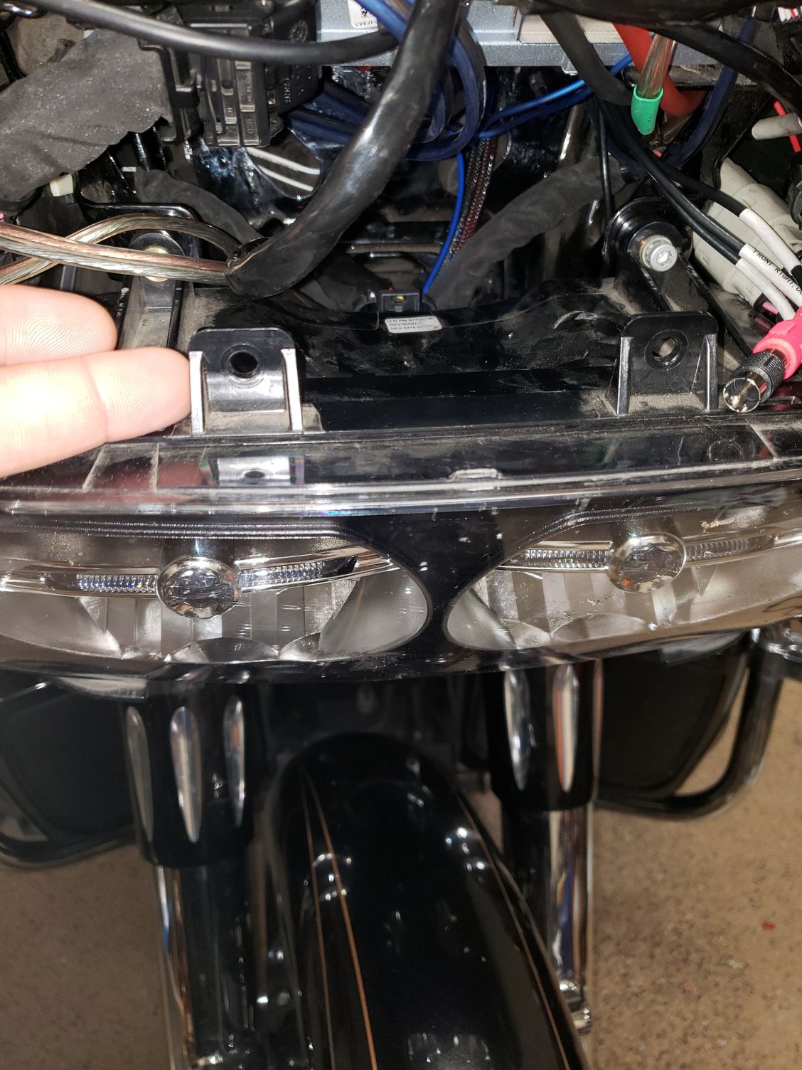

    I could probably fit my DA HXM in my fairing if these weren't there can i shave them?
    I shave these tabs on the top of the head light so I can fit this amp in fairing?
