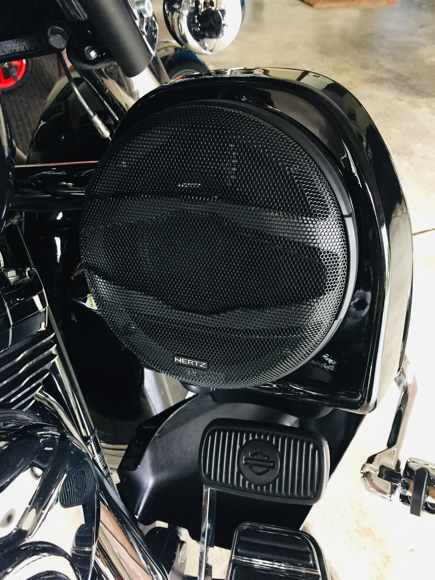

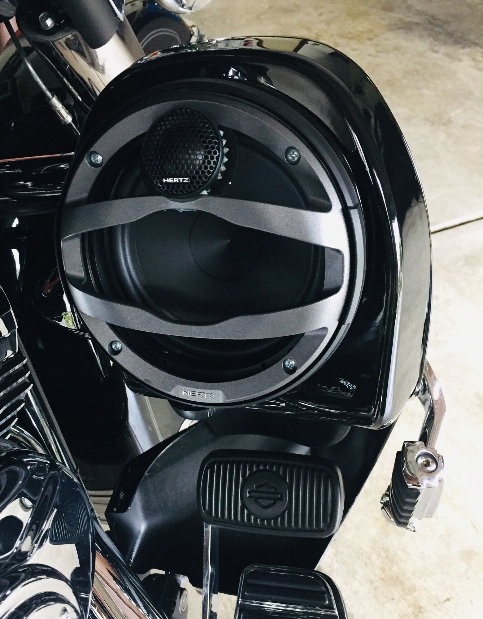

Sell the Arc Moto 602's. Purchase two sets of for the upper and lower fairings...
https://www.amazon.com/Hertz-165-3-Speaker-Component-System/dp/B016YLM6B4/ref=asc_df_B016YLM6B4/?tag=hyprod-20&linkCode=df0&hvadid=312070784062&hvpos=1o3&hvnetw=g&hvrand=14023712601029243090&hvpone=&hvptwo=&hvqmt=&hvdev=m&hvdvcmdl=&hvlocint=&hvlocphy=9021494&hvtargid=pla- https://www.amazon.com/Hertz-165-3-Speaker-Component-System/dp/B016YLM6B4/ref=asc_df_B016YLM6B4/?tag=hyprod-20&linkCode=df0&hvadid=312070784062&hvpos=1o3&hvnetw=g&hvrand=14023712601029243090&hvpone=&hvptwo=&hvqmt=&hvdev=m&hvdvcmdl=&hvlocint=&hvlocphy=9021494&hvtargid=pla-
You can mount the tweeters where you intended to in the upper fairing and the lower tweeters undet the speaker grills aimed toward your listening position.
Use the Arc Audio 600.4 to power all four front speakers and you’ll have a perfectly matched and very powerful front stage.
Add the Hertz MPX 690.3's to the lids with a two channel amp of your choice.
Set the gain on the lower fairings slightly higher than the upper and the cross over on the lowers to +2db with the upper fairing crossover flat. (That’s what I did). With the front to rear fader that’s about all you’ll need for tuning with this perfectly matched system no dsr-1 would be needed.

Thanks for the info. Where did you mount the 2 small component boxes? And not sure where you talking about tweeter mount on lowers?
Old Dec 12, 2018 | 07:58 PM
DLennartz's Avatar
DLennartz
Joined: Apr 2013
Posts: 166
Likes: 20
From: Illinois
