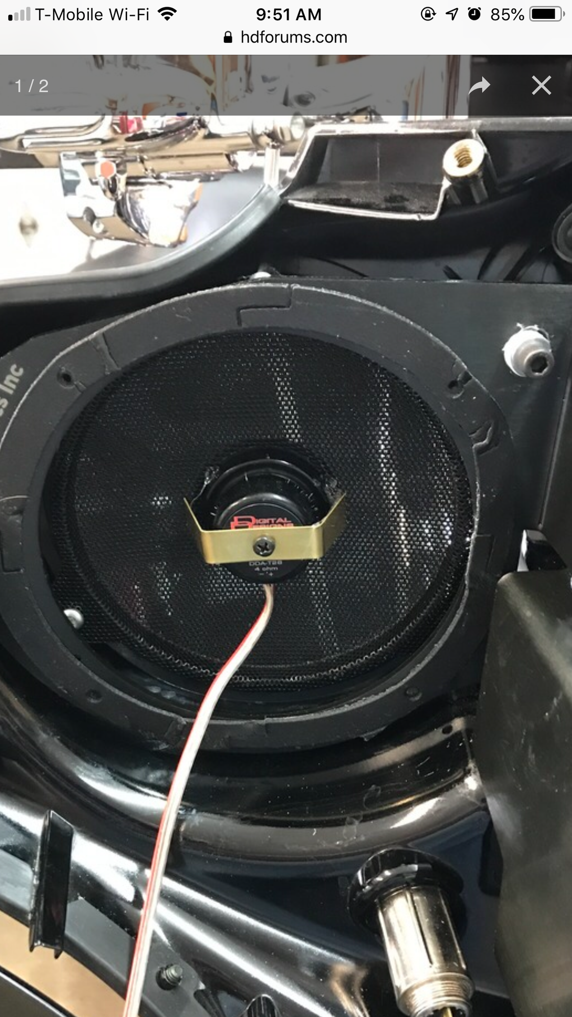

Not sure if those Hertz come with brackets, but you can easily make some similar to this

Fabrication for dummies
