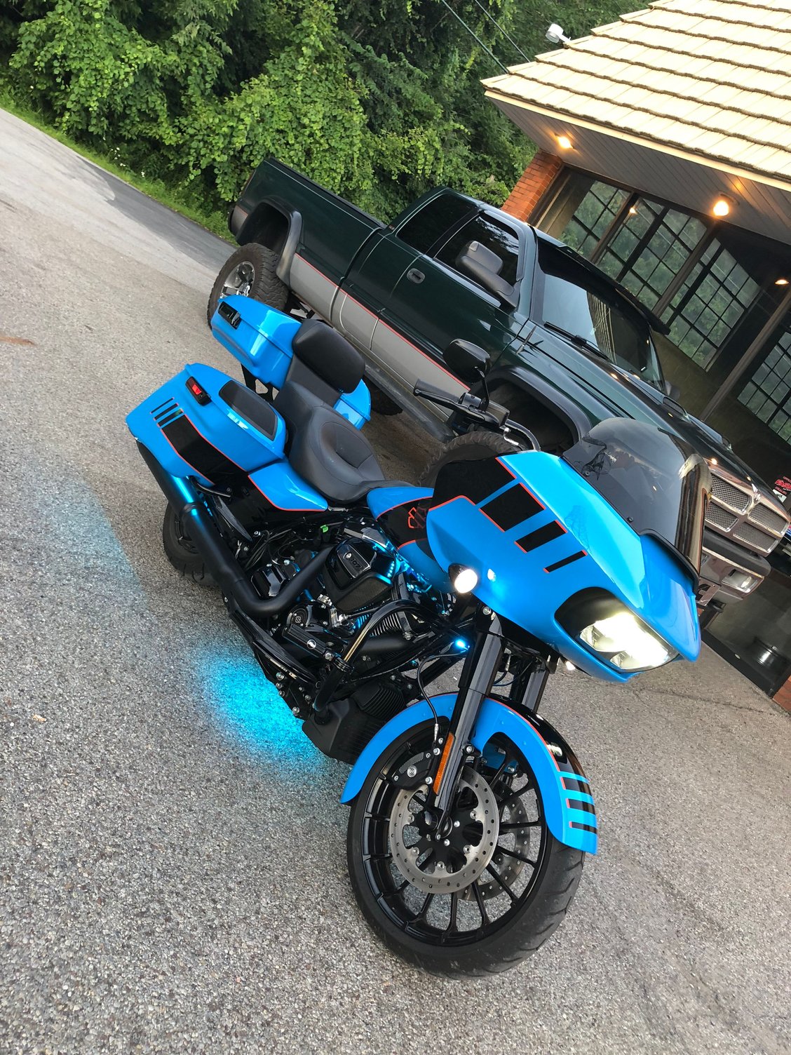

New to the audio world. Have a 2018 rgs with speaker lids and am trying to get together some info to build a nice system for it.
I have used j&m in the past and wasn’t impressed. I have heard soundz systems and I like the clarity and volume but know something can be built for way less that will sound as good or better. At least what is what I have gathered by reading a few of the threads here.
I would prefer to minimize cutting and splicing wires as much as possible but if it’s what needs done to put in the best system then it is what it is. I would also like to keep the stock hu at least for now anyways.
As for price I would like to be $1500-$2000. Biggest thing is clarity as well as volume. So far the motor and exhaust is stock but only for a little longer so I want to make sure I can hear everything loud and clear at highway speeds even after adding an exhaust and other goodies.
What parts and advise do you guys have for me?

Damn good looking scooter Justin and welcome to the forum. A couple of questions. Is your setup stock HR? Are the lids 5x7? Any boom amps in play? Do you have fade control on your HU for front to rear? That will help determine just what you will need.

thanks! Everything is stock that would come on the rgs. Only addition is the 5x7s in the bags which was an option with the paint. There are no amps in the system and I do have fade control on the radio.

Ok because you have fade control already, you wont need it flashed for that. You will need 2 bt355 line levelers to flatten out the drastic eq curve that the boom HU gives to try to make it sound good. One for the front and 1 for the rear. I suggest replacing the rear 5x7's with 6x9's to add a fuller sound from the rears. That can be done by 6x9 adaptors. A good 4 channel amp will be needed to any aftermarket speaker. You will need an amp wire kit to run power from the battery to the amp. No cutting of any stock wiring will be needed to add an aftermarket setup. The line levelers will plug into the speaker outs from the HU and rca's from the LL into the amp.
As far as speakers go, there are a bunch of different coax that will sound good but that depends on you listening taste. Research threads on this forum and others to find what people like depending on music taste and riding style. 6x9's in the rear aren't as bad to narrow down as there are some good quality 6x9's that will fill your needs. The new mmats pa 690.4 cx4 are some of the best as the hertz mpx are also some of the best.
I personally like the hertz hcx 165.3 for the fairing as they are bullet proof and provide some good SQ for the price.
One of the best 4 channel amps is the stinger spx 700/4 and is easy to install and tune. There are others out there but for the $$ and SQ, it is hard to beat the stinger.
Hope this helps.....
