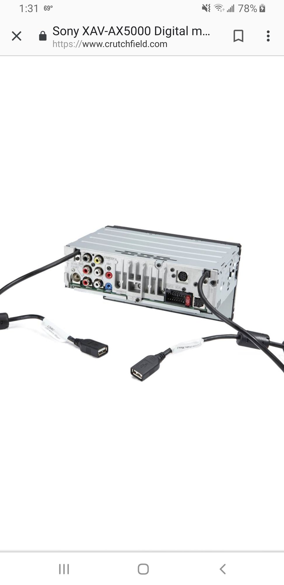

So I ordered this, then thought, how the hell do I get the USB from the back of the radio to the front of my Fairing? How did you guys do that?

I've got plenty of those. The question is how do I her it from inside the Fairing (to attach to the back of the radio) to outside of the Fairing? Or am I missing that there is an external USB on the front of the radio? If that's the case I'll feel pretty stupid for posting this.

How do I get the wire from the back of the radio to where it is accessible on the front ?

If it’s 14 and up drill a hole in back of glove box and feed it through. 13 and down drill a hole wherever you want
I’m pretty sure there’s two I believeCheck manual or look at the unit ����

Glove box works for me.

Or come out where the bars come out on the side if your using a phone cradle on the bars.
Be sure to tape your connections together in the fairing.

Like Frenchie said, if it's a Rushmore, you just remove the existing usb cord from the cubby hole and insert the Sony usb cord through the same hole. The usb cords on the Sony XAV-AX500 are about 3 ft. long. Real simple.

Good info. Ill just replace the existing USB from the glove box.

Thats what I did. I removed plug holding stock HU usb and ran both of the Sony usb cables with the plug through existing hole to the same cubby hole. Then I connect dedicated phone foe AA NAV to USB1 and thumb drive with music to usb2.
no need to drill a hole or change routing from stock path.
