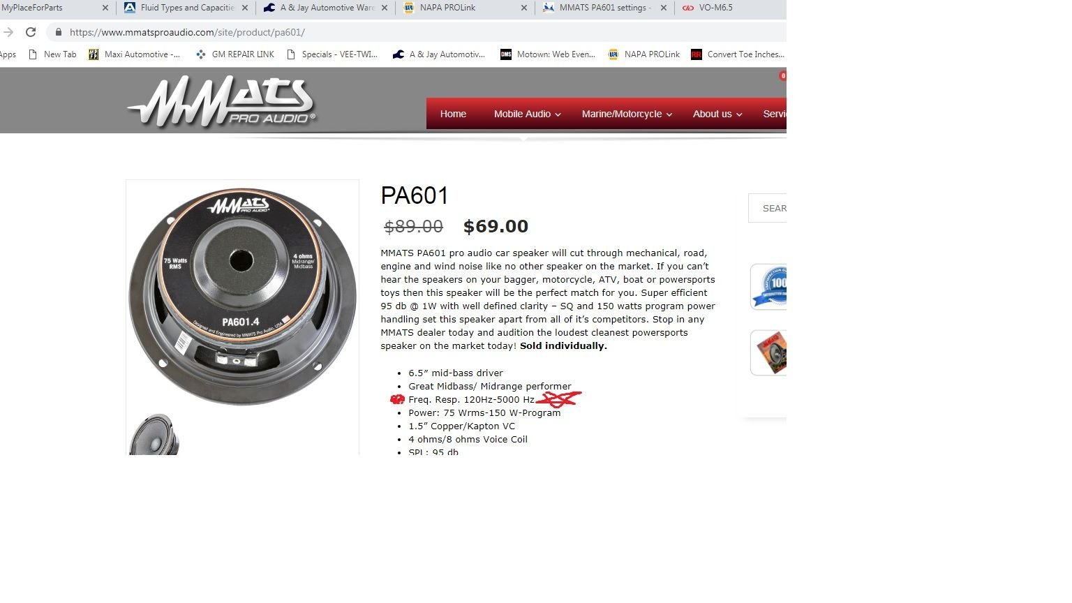

Juice is right. If you wanna feed em power you’ve gotta cal highs and lows. I was running mine with wayyyyyyyy too much power according to specs but they were loud and clean crossed 110, maybe 100 (it’s been awhile) and capped at 4500.
You ca run them lower and higher on the crossover but you’re going to have to dial back on the juice.
