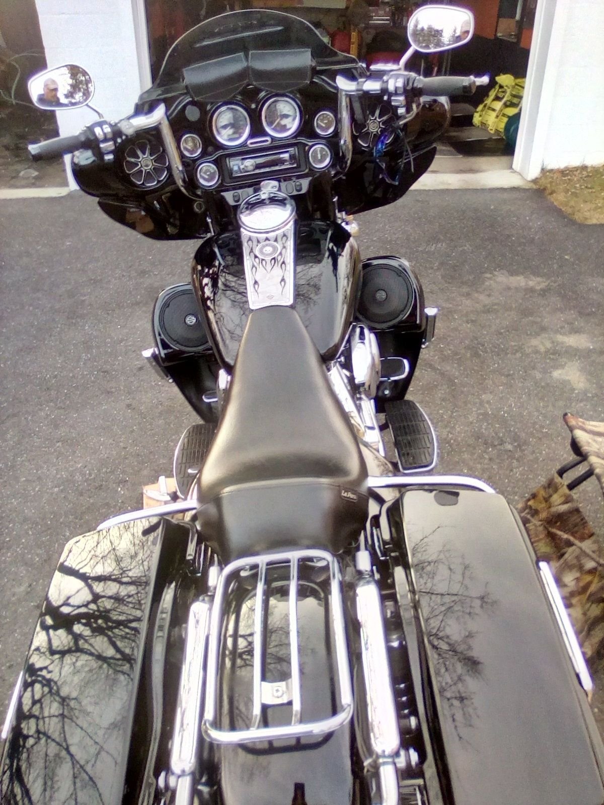

Old Apr 28, 2019 | 01:33 PM
travelingypsye's Avatar
travelingypsye
Joined: Dec 2017
Posts: 3,371
Likes: 689
From: indiana
I got my lowers off ebay painted black and ready to go. Since you have coax in the fairing, a good set of mid range will blend well with your fairing. I am running a set of hertz sv 165's as they dropped right in the lower pods, get real loud without a bunch of powe and blend well with my fairing setup.
