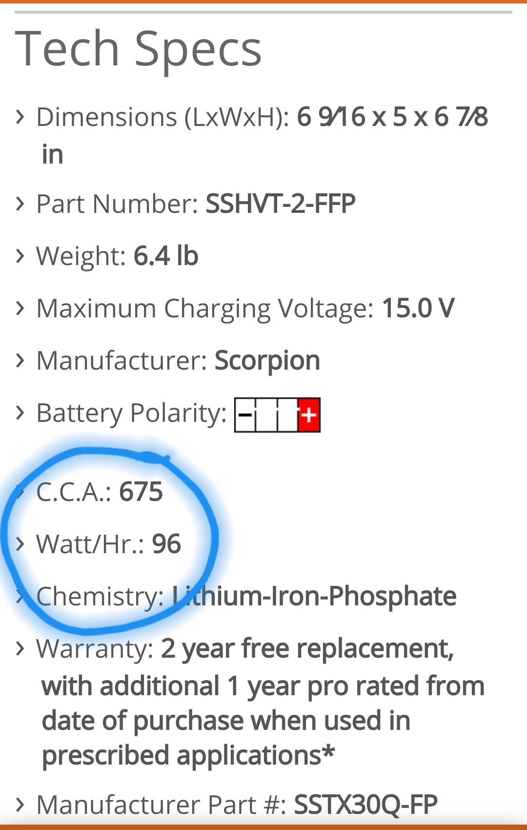

Heres the scorpion battery I got 675 CCA and 96 amp hour rating and it weighs only 6 lbs.. highly recommend
Stinger battery
Stinger battery
That's not 96 amp hours man!! That thing would be HUGE.

96 watt hours, the converter I found says that equals 8 amp hours.
Haze..i stand corrected...I.am so use to seeing AH I spoke to soon.
but stinger doesnt rate their batteries that way...my bad

While the weight on those Stinger batteries sound pretty interesting, the 96 watt/hr sounds crazy low? Just run of the mill Yuasa replacement AMG's run about 500 CCA and 30-32 AMP/Hour which is approx 3-1/2 times more? No doubt those Stingers sound like nice batteries, but not for parking lot DJ's. What am I missing??

The more of the page you read the more often it says "scorpion batteries" I firmly believe the stick stinger in there to confuse people into believing it's a Stinger battery as in AAMP of America.
