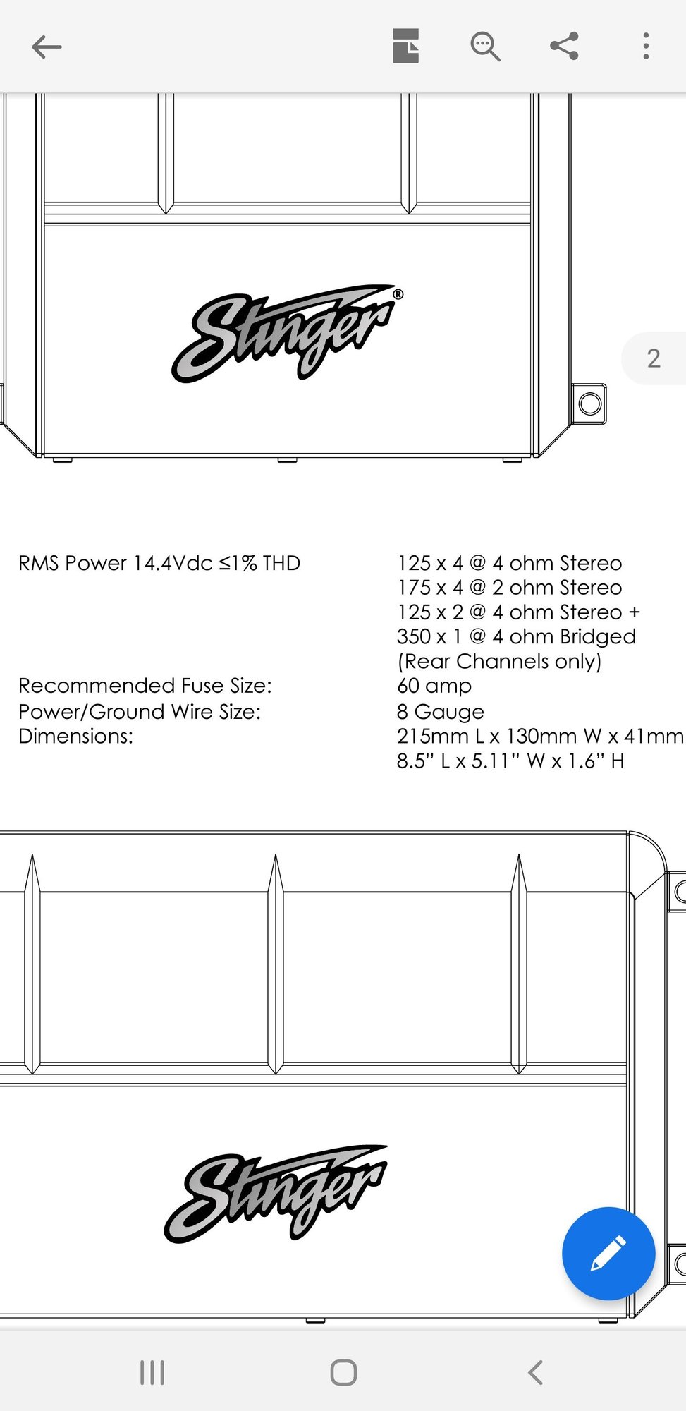

Upon a little more research, I find that the Stinger only allows the 4 ohm bridge on the rear channel. I can not run both at 350 watts. I guess we are back to the beginning on this.

Old Jul 12, 2019 | 09:46 AM
Do a little more research. Specs on their website states 350x2 @4 ohm.

I saw that. That's why I wired it that way. In fact, the input pigtails even have a diagram of what to bridge. I posted a copy of the manual...and I'm thrown off. Both of the other amps are in power mode. All I can think of is the bridging issue, as there are no fuses on the amp itself.
