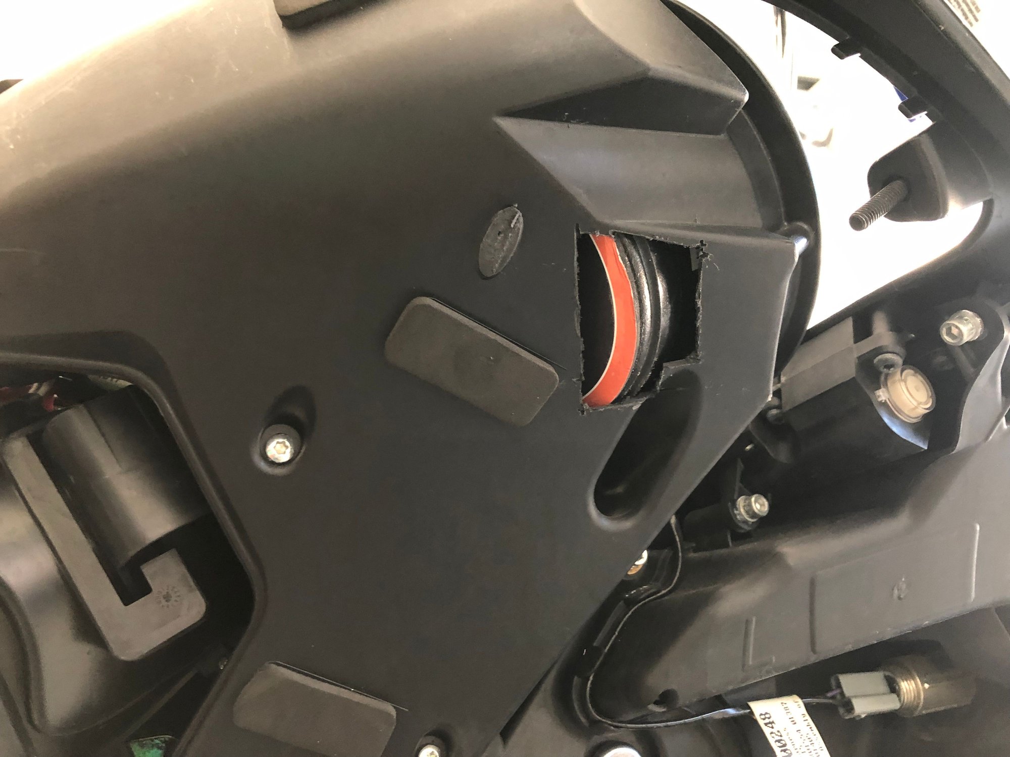

Yes, use the BT LL. as for the speakers the MMats are great and they are what I use in my RG fairing. You will have to modify the speakers pods to make them fit.

Disclaimer since it hasnt been mentioned. The mmats will have to be mounted with the logo upside down. I only mentioned it cause it bugged the crap out of me at first, but with the RF grills I dont see it anyway.
